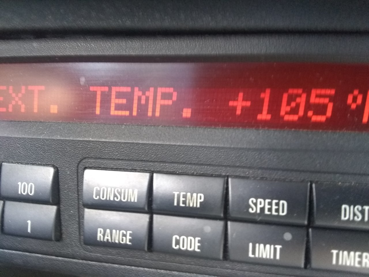

    I installed a rear view mirror with temp readout and had to put a new second sensor behind the grill, right next to the factory one, cause I couldn’t figure out how to tap into it for the mirror.

    My mirror kit specifically said a 2nd sensor is mandatory. I figure if the truck is moving the temp should be accurate.

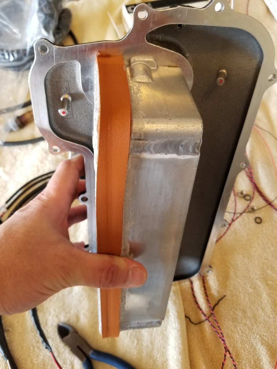

    Anybody have tips on properly installing an intercooler foam gasket? Being that some of mine is missing I dont have a visual .

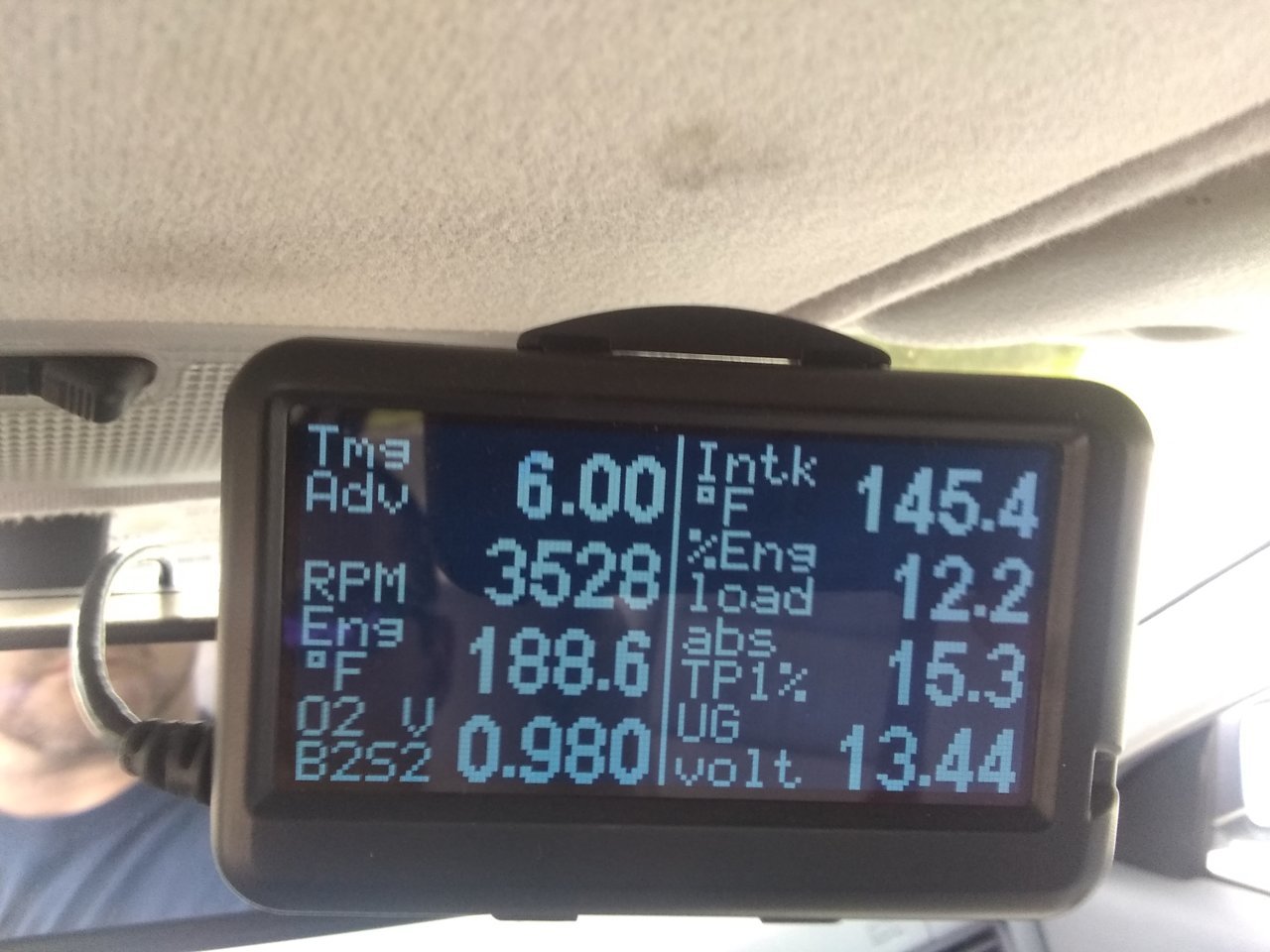

    Because unless you have enclosed your filter you are pulling from your hot engine bay. Shroud that filter.

    Its only if you have an outside temp gauge. I bought an aftermarket rearview mirror with temperature, compass, and garage control. I had to install the temperature sensor in front of the grill.

    Where would one get said foam tape?

    Thank you sir! Are there clips at both ends?
    Think I only saw a clip on one end last weekend.

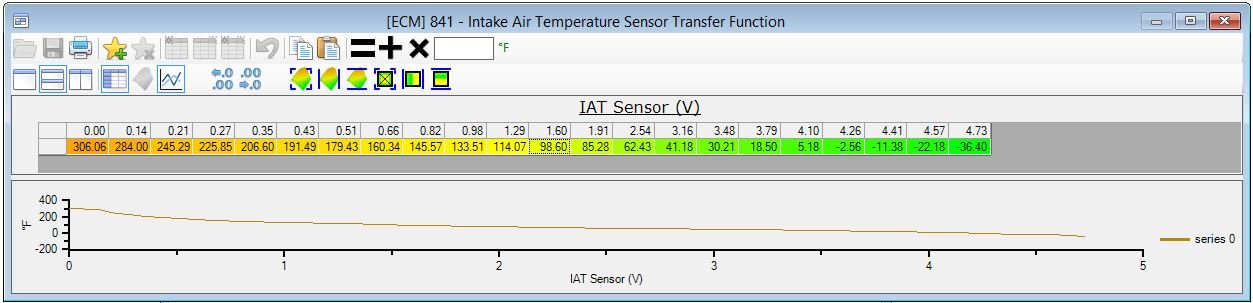

    I no we have a lot of smart guys in here. I really want to take a iat sensor. And put it after the intercooler for our trucks. With meth and my ice box I want the iat to be accurate. If it’s getting way cooler air and the truck doesn’t no it then what’s the point. I know it just needs to be a 2 wire sensor and then cut the 2 iat temp wires from the maf and run them to it. But I no the maf reads a resistance to figure out the temp and making that work on say a gm iat. Is making my brain hurt lol. Also. If spraying meth is even gonna work. If meth gets onto the sensor will it make it not read correct. It needs to be like a brass type sensor like a coolant temp sensor. I don’t no. I have a lot of ideas and not the brain power to make it all happen. But I was hoping with all the brain power on here we could figure it out. Anything will help guys. Thanks.

    With HPTuners, you can use a separate IAT sensor independent from the MAF and plumb it post intercooler if you like. You'll need the calibration details for the sensor though to set the table up though.

    So maybe we can get iat numbers from a gm and get it to work easily.
