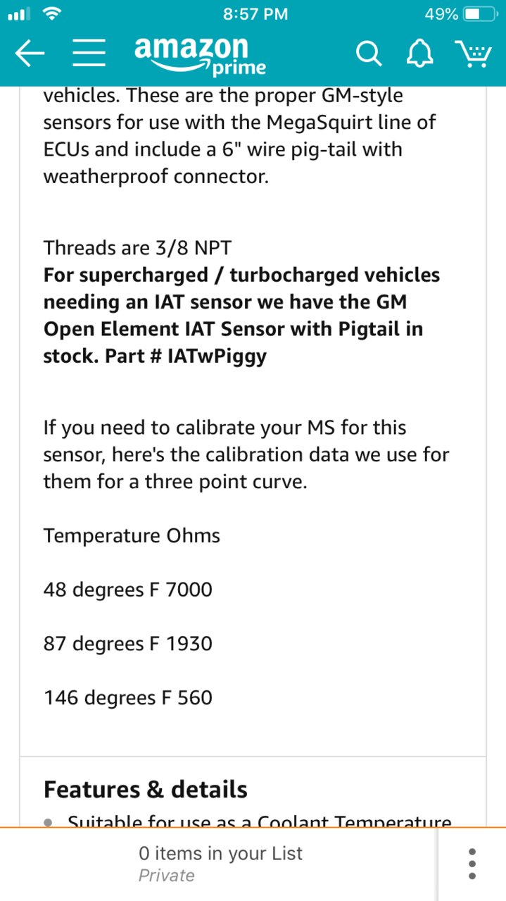

    Only reason I asked about ohms is because this was in the discription. 29113AA1-DE36-435E-9BFD-0B90AF7E192C.jpg

    U think all gm sensors are the same?

    The GM IAT sensors are THE most widely used IAT sensor used for aftermarket ECU's. Buying one from Autozone is the same as buying one from AEM.

    I see there is 2 different ones. Open element and closed element. It says to use open element on forced induction. But the open element wouldn’t work with meth I feel like. I don’t see why the closed element wouldn’t work.

    You'll have to balance the Pros/Cons of the open vs. closed in relation to your new mounting location. Just keep in mind the closed element will heatsoak much more-so than the open element.
