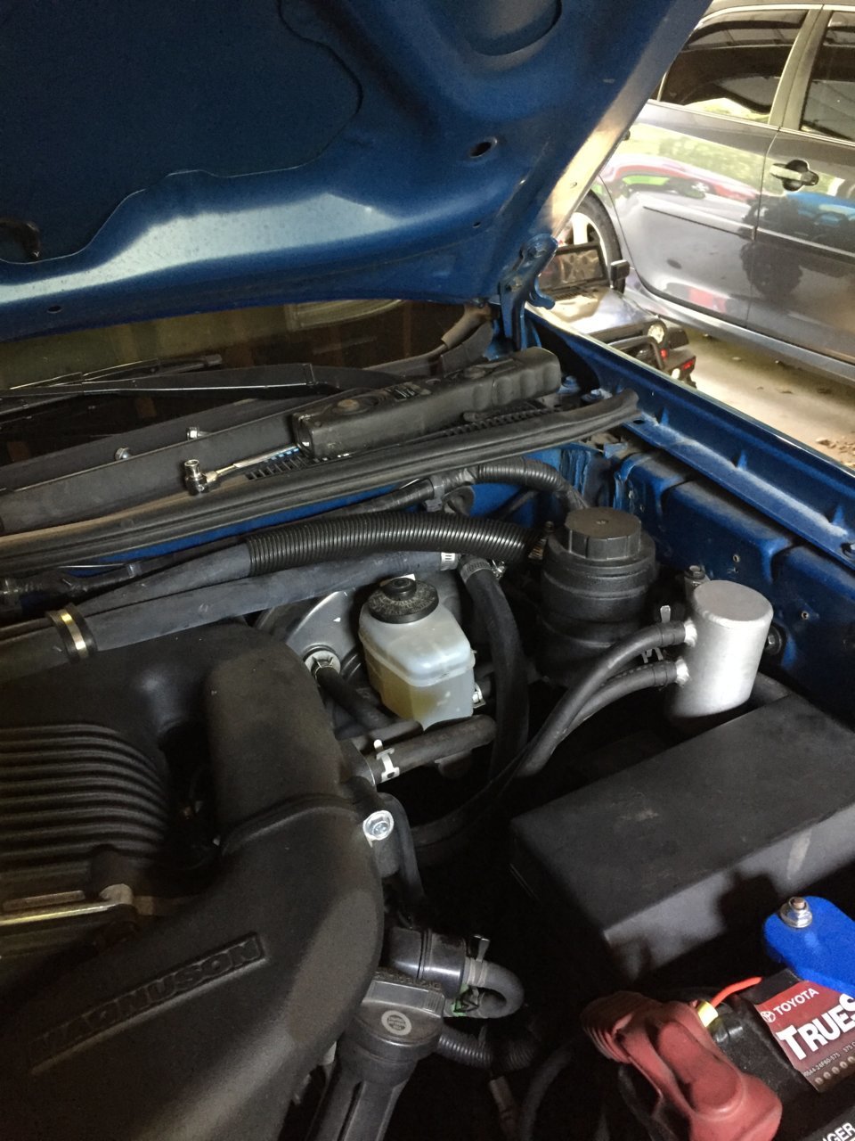

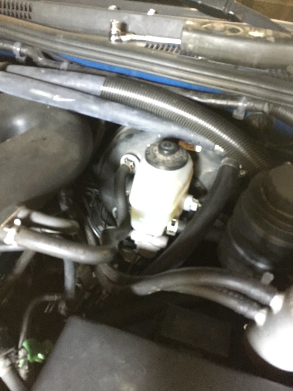

    Ok after some test fitting, I think the pulse damper and fuel inlet locations need to be reversed. So this will be the recommended orientation.

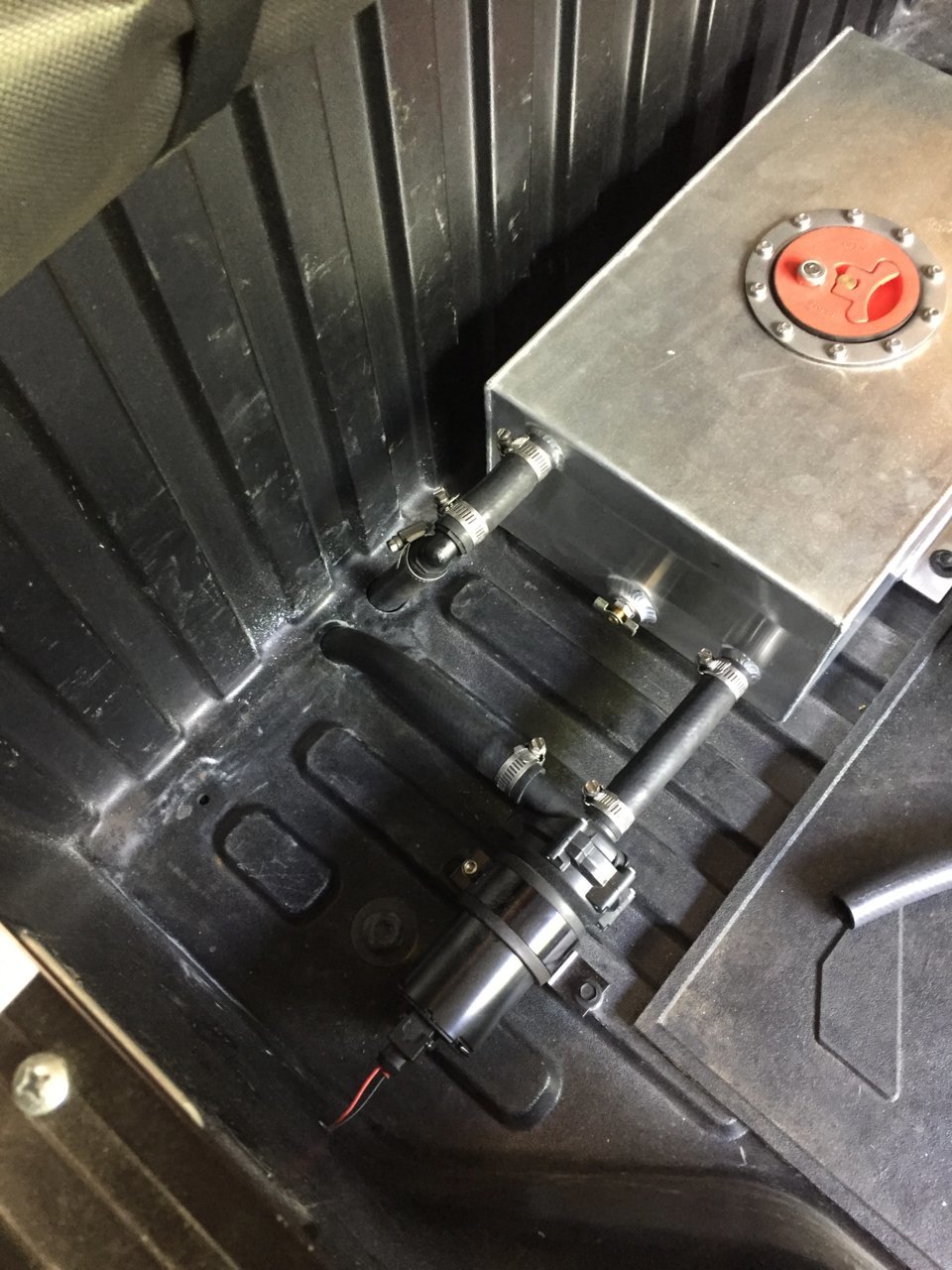

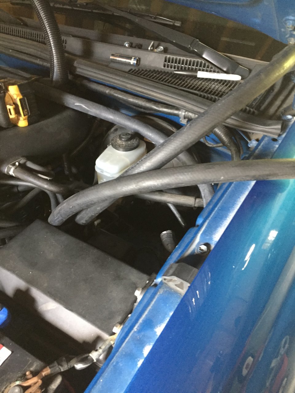

    Got some stuff done today. Just ran out of wire. So meth kit and ice box will be done hopefully by next weekend.

    It looks good, but you my want to add rubber grommets to those holes honestly my man, otherwise you'll slice those hoses and wiring real quick with a few small movements of the bed or chaffing of the hose and wiring itself.
