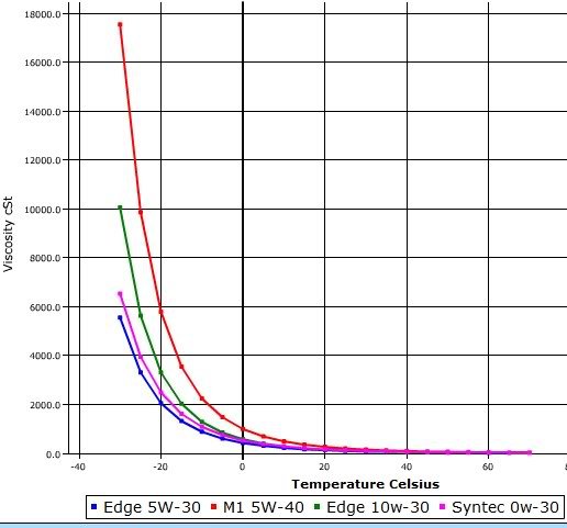

    I'm in Canada and I wouldn't run 0w-30 in an engine unless it calls for it. Call me silly but I believe that the engineers who designed our engines knew what weight would work best. Especially given that the VVT-i system relies on viscosity to function correctly. When you change the cold viscosity number, you effect the viscosity all the way up to operating temperature. I'm perfectly happy sticking to 5w-30. That being said, there isn't much actual difference between 0w-30 and 5w-30 on most charts I've seen so you could probably get away with it. Going to 15w-40 though... just pray you don't have to start below freezing!

    I added some more information. The real risk is if you have to start below freezing. Up top there is a surprisingly little difference between a 30 weight and a 40 weight. However, below 0c, the difference between a 0, 5, 10, and 15 weight are pretty extreme. Especially between 5 and 15.

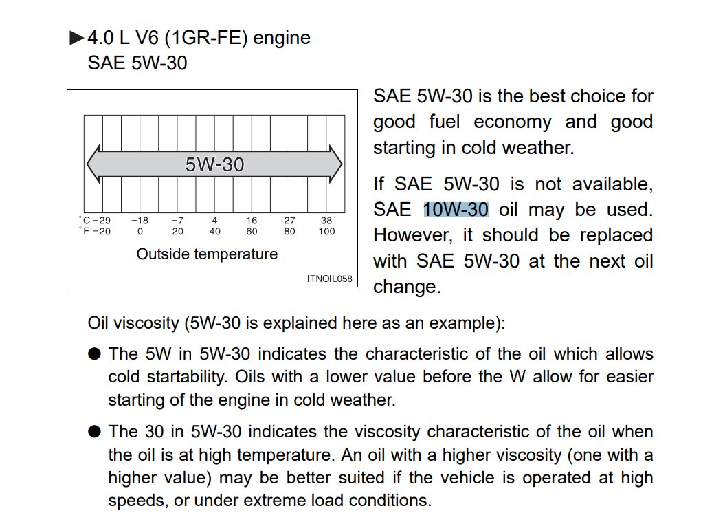

    "Cold" is somewhat relative, in that most engine wear is at startup when, no matter what the temp, oil isn't flowing throughout the engine and takes some amount of time to do so. Zero-weight oil minimizes the time, regardless of the ambient temp, minimizing the wear.
    According to pg 536 of the 2014 Toyota Tacoma Owner's Manual, "SAE 5W-30 is the best choice for good fuel economy and good starting in cold weather. If SAE 5W-30 is not available, SAE 10W-30 oil may be used. However, it should be replaced with SAE 5W-30 at the next oil change."
    Pg 456 of the 2013 Owner's Manual contains similar verbiage.
    As indicated in the Owner's Manual excerpts, that's not how oil viscosities work. It also doesn't account for the decreased shear that occurs when running high-quality synthetic oil.

    I know this will be stirring the pot here, but from another oil thread, here is a picture from a vehicle’s owners manual that has a 1GR-FE in it where the countries don’t have CAFE regulations.
    Same Toyota engineers, same engine, different regulations to follow being the only difference.

    For reasons that escape me, oil discussions always devolve, like those about politics and religion.
    Your point about CAFE standards is well-taken. In the end, we're all free to choose the oil (brand, type, viscosity, etc) with which we're comfortable. There's little value in arguing about it, and there's probably little difference in engine protection as long as you're using quality oil & filters and changing them regularly. :cheers:
