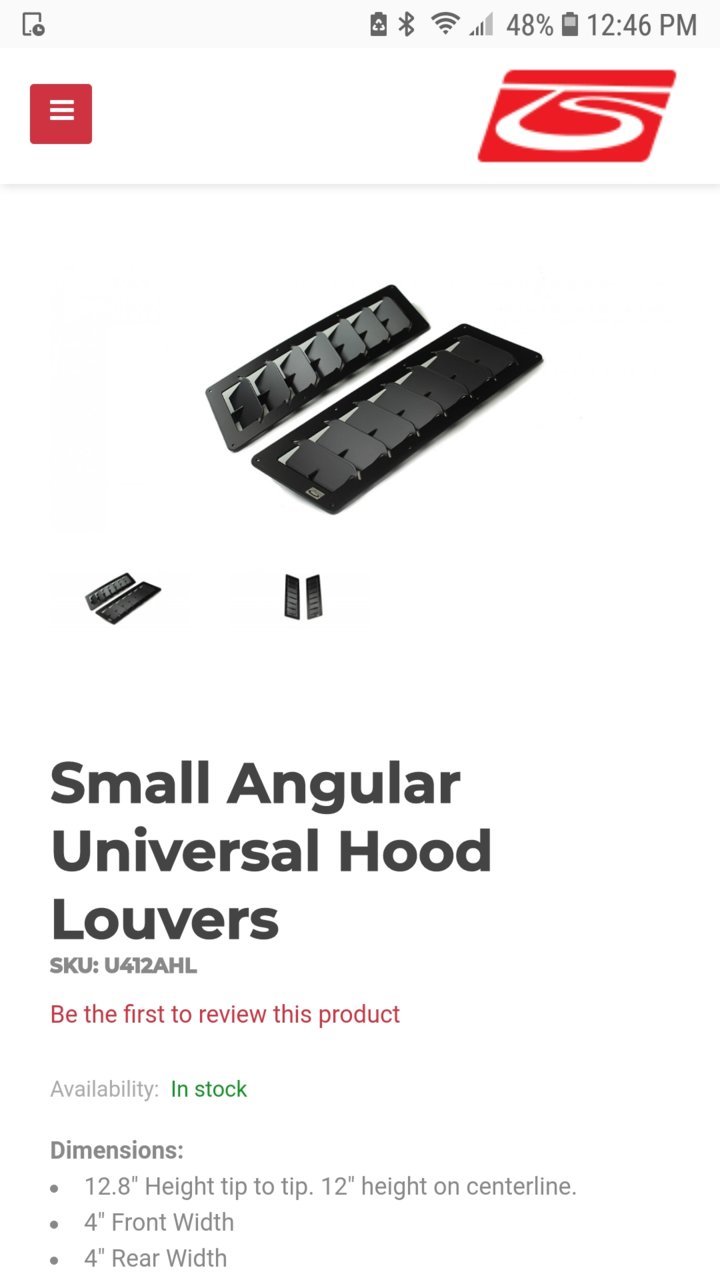

    I did like those. But I figured you get what you pay for. The aluminum ones for the Toyota 86 are 200.00. And, on high performance toyotas:)

    I know what you mean. No need. But everything in the engine bay is too tight. No rubber hose would even fit around the hose where I routed it.

    Where are they for sale? I would aluminum too. Something else to get powder coated.

    Ebay. I'm no good at links search Subaru brz Toyota 86 hood cowl vents.

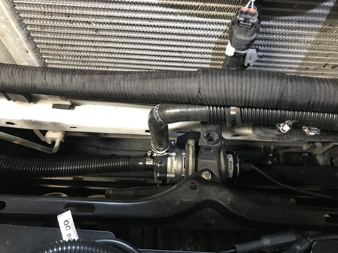

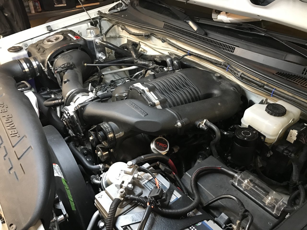

    Replaced leaking intercooler hoses, installed new reservoir, new Bosch pump and oil catch can. Copied a bunch of you guys on these mods. Thanks y'all.

    I like those HPS silicone hoses in there.

    Reservoir looks good
