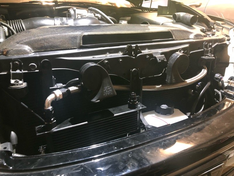

    Well. Time to go back to the SS hose. The rubber hose I got is just as thick, if not thicker than the existing SS I have. So that won’t work.
  12. Jun 12, 2019 at 10:06 AM
    Kelvin
    Kelvin Wheeeeee
    Mar 8, 2013
    #99256
    2,884
    16’ GX460 with some junk bolted on
    But...the rubber hose is easier to bend so that could be a plus...

    Silly idea time. What if I wrapped my meth tank with those heatshield stuff you guys were talking about a few days ago?
  14. Jun 12, 2019 at 1:09 PM
    DocME
    DocME Well-Known Member
    Aug 24, 2018
    #263956
    1,583
    California
    '07 FJ Cruiser
    TRD S/C, UCON, 61# inj, 2.5 pulley, 7th inj, Roostfactor Y Pipe, URD exhaust, WAT Nomad Valve body, Dana 60, DK LT, JD FAB LCA mounts, custom roof rack...and way too many others.
    I don't see the value wrapping the meth tank as you're going to be trying to atomize it and seek the benefits of the phase change to a gas. There could be some very subtle benefits of it being cooler in liquid form but I'm not sure if you'd see the benefit. Now wrapping your inter cooler tank, I could see that. Just my 2 cents.

    Well how about if I’m running just water? I’m running it strictly for cooling since these older units didn’t have an intercooler.
