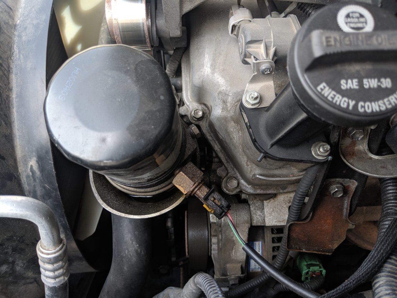

    Here is mine. Needs no sandwich plate.
