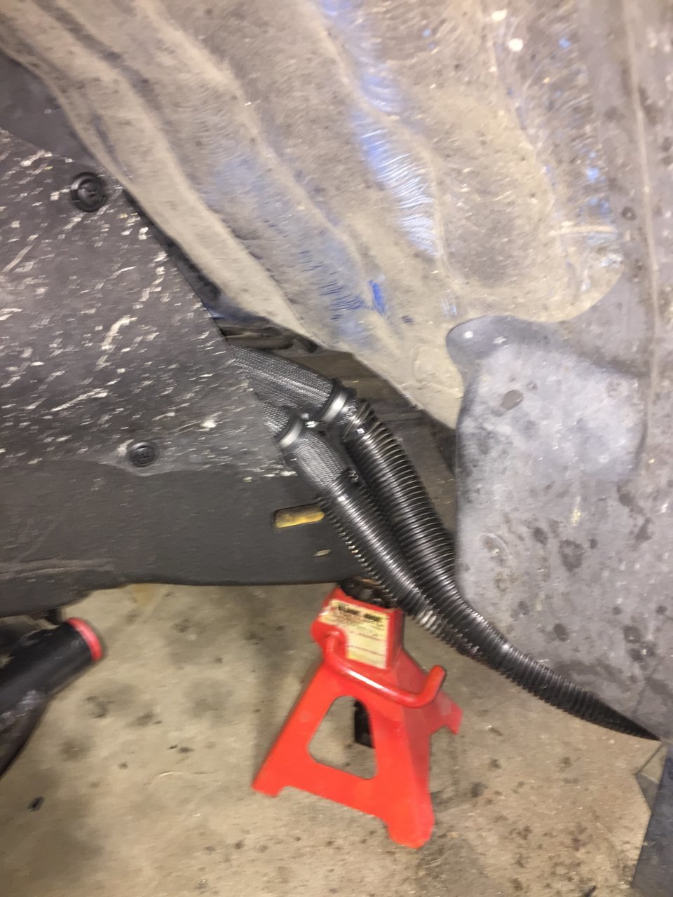

    Got the hoses all secured. Wiring is almost done. Just have to run wires to meth pump. Wires to second coolant pump in bed. And the meth hose from pump to underhood. Then finally drive it.

    Getting close. Test drive today?

    No ran out of wire. I’ll get it going this week. Got a little xrunner meet next weekend so she will be done by then.
