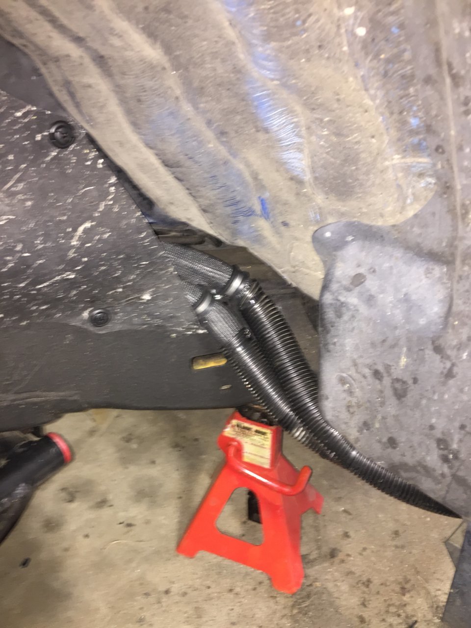

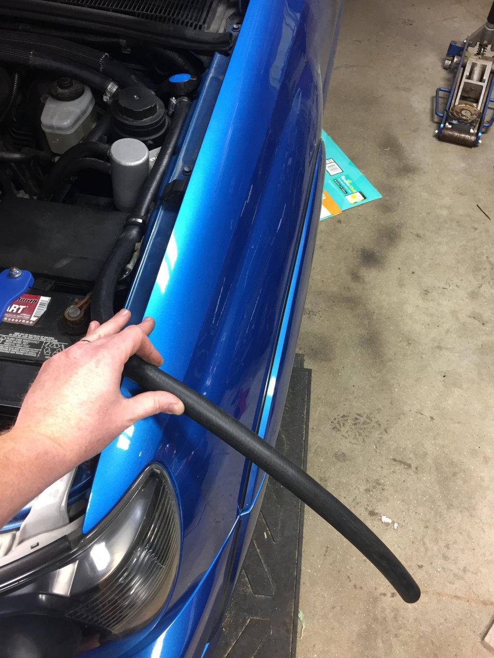

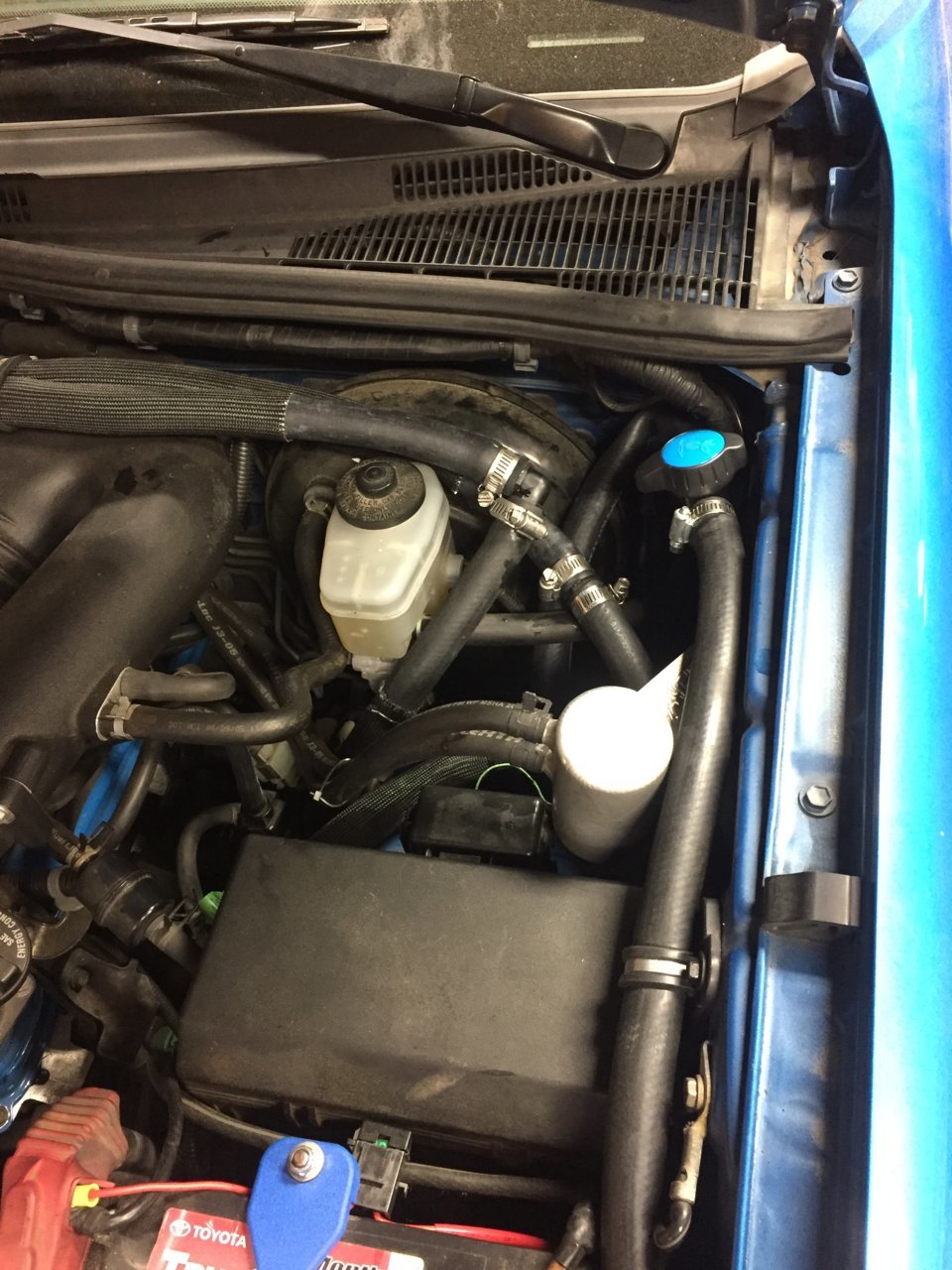

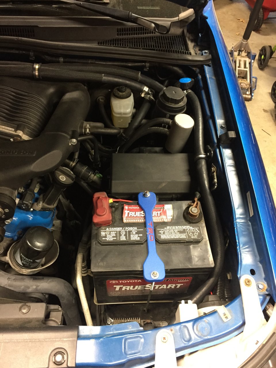

    9B1C2310-9804-4D5F-90F6-9A72B28E35BF.jpg 96796EED-4BFB-44E4-B665-0ABBC4B29728.jpg A35A7B6B-D3AB-43B7-A122-90E9069141D1.jpg Finally got ice box done and working. Made a drain attached to the return hose. So I can drain out some water and add ice. After trying to bleed it I found I needed to remove the stock overflow. It was making air in the line. Tried for 20 min with air pockets and spraying water at me. Once I removed it. It was fine. I just have to swap some hoses around when I go to the track so it bypasses the heat exchanger. Pretty happy it’s done. Gotta finish meth now...
