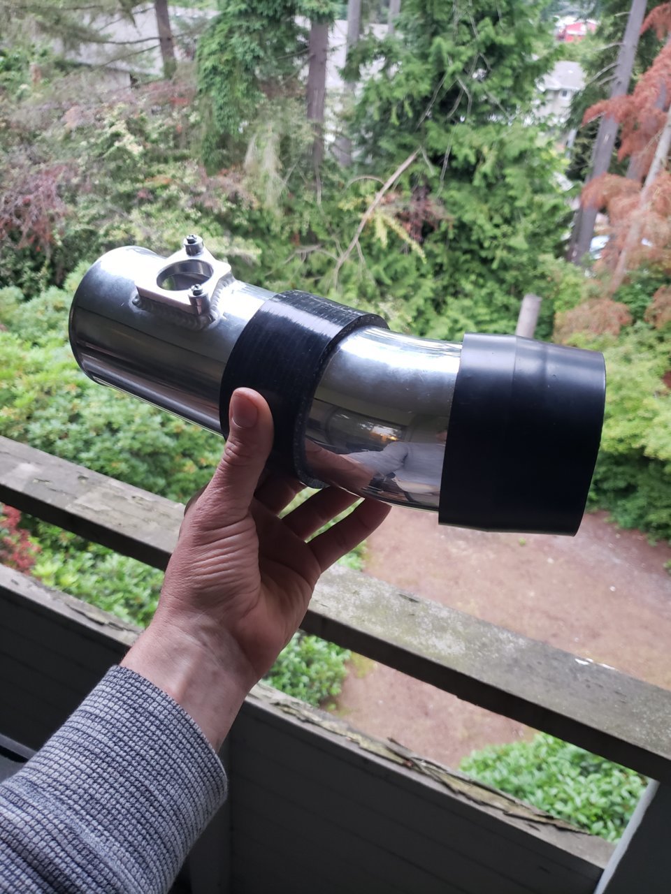

    No. New parts. Tacoma maf @JustDSM says it will adapt fine with tuning. Its halfway done here.15612612760538055080522027573629.jpg

    Spent most of the day making a new meth pump bracket and s/c pump bracket.

    Nice! Will you be able to read more than the 324 g/s once you get that installed?

    The g/s #s is something @JustDSM can confirm. I have no clue.

    If it’s larger in diameter than the aFe you were using (or stock), it should calibrate to read higher than 324.

    Afe is 3" I think. Maybe a little under. I have 3.5" now. Will need to coordinate with you when I install. Cutting the afe as it reaches the bell near the filter will be a one shot deal!

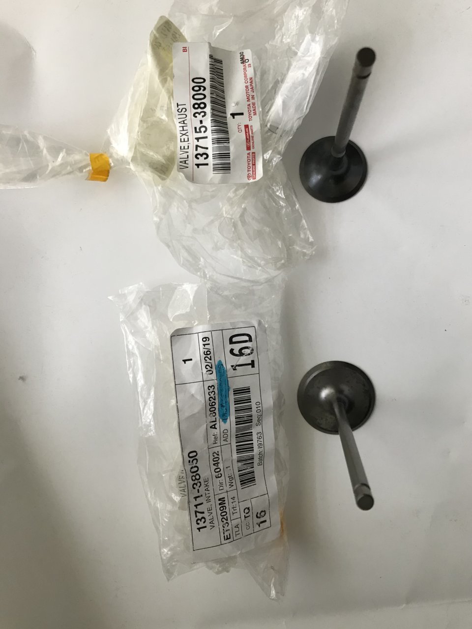

    A titanium valvetrain was always one of the most ideal ways to increase redline capabilities safely without inducing valve float on the LS engines back when I was in the muscle car world. It was an expensive mod, however, was well worth the trouble and results.
    The only issue with doing such a mod is it requires extensive work for said results. If you have major engine troubles though, this would be an excellent "while I'm in there" sort of upgrade.
    It would be well worth investigating to see if dimensionally, the 1GR valves and these valves match up.

    1GR-FE (Single VVTi)
    Intake
    Head Diameter: 36.55 mm
    Stem Diameter: 5.47 mm
    Overall Length: 107.1 mm
    Tip Length: 2.250 mm
    Exhaust
    Head Diameter: 29.5 mm
    Stem Diameter: 5.46 mm
    Overall Length: 105.95 mm
    2GR variants
    Intake
    Head size: 38.0mm*
    Stem Diameter: 5.5mm *
    Tip Length: 5.5mm *
    Exhaust
    Head size: 32.0mm
    Total length: 110.4mm
    Tip length: 5.5mm
    *From non-technical literature
