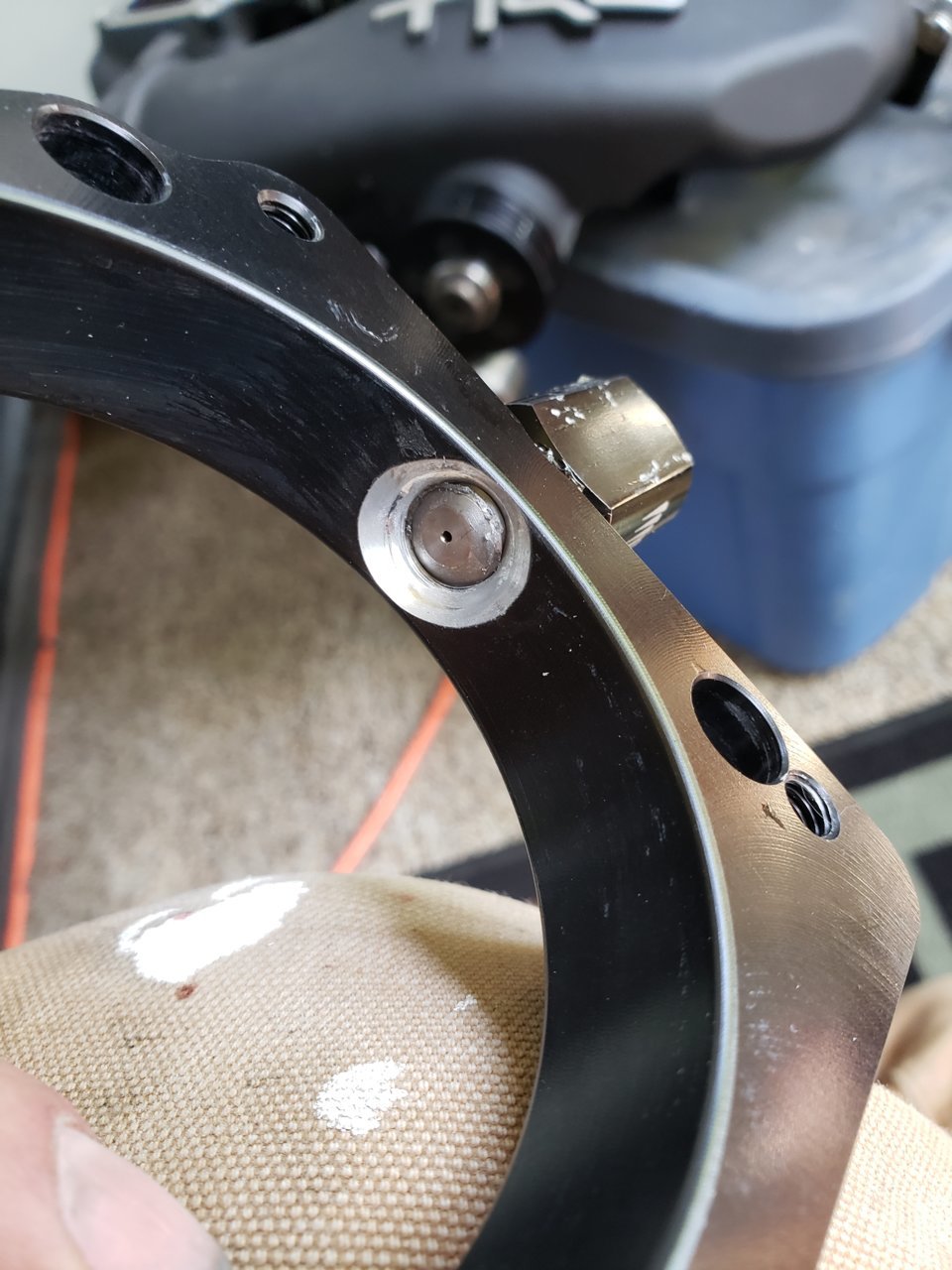

    @mightytacoman made a pretty sweet adapter plate for his 76mm. It would fit a meth nozzle a little easier than the urd one. But it can be done if you're careful.20190601_120551.jpg
