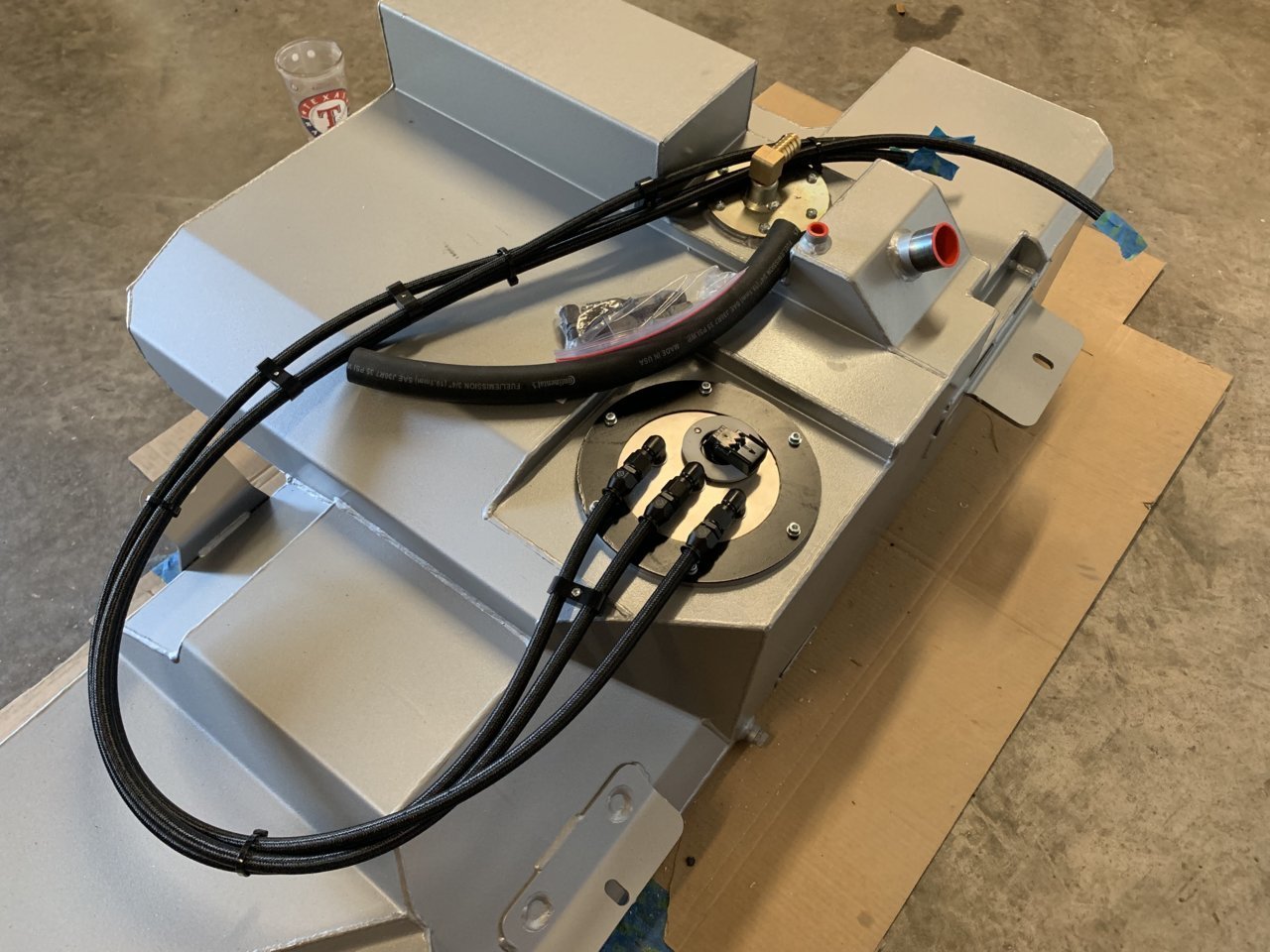

    Ah ok. Not that I know what most fuel pumps look like but I just install a 153L long range fuel tank to my Hilux and obviously I had to take out the fuel pump and to me it was actually a fair size pump. But as I said I can’t compare it to anything else. I might have to do some research one the Hilux pump and what you guys have in the Tarcoma. Maybe I might strike it lucky and the Hilux might have a slightly more powerful pump.

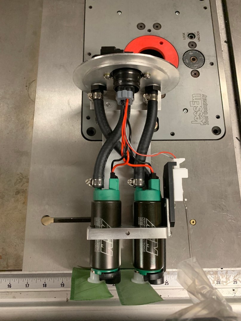

    I can post you a picture of what the OE sized pump looks like and you can see what it looks like for comparative purposes. The one for the Tacoma is ridiculously tiny, it's sort of insulting even for non boosted guys.

  12. Jun 24, 2019 at 12:26 AM
    loginfailed
    loginfailed Well-Known Member
    Aug 29, 2016
    #195923
    5,156
    Dwayne
    Houston, TX
    2014 DCSB 4WD
    Nice! Long Range Automotive? Mine is 135L.
    I have dual fuel pumps.
