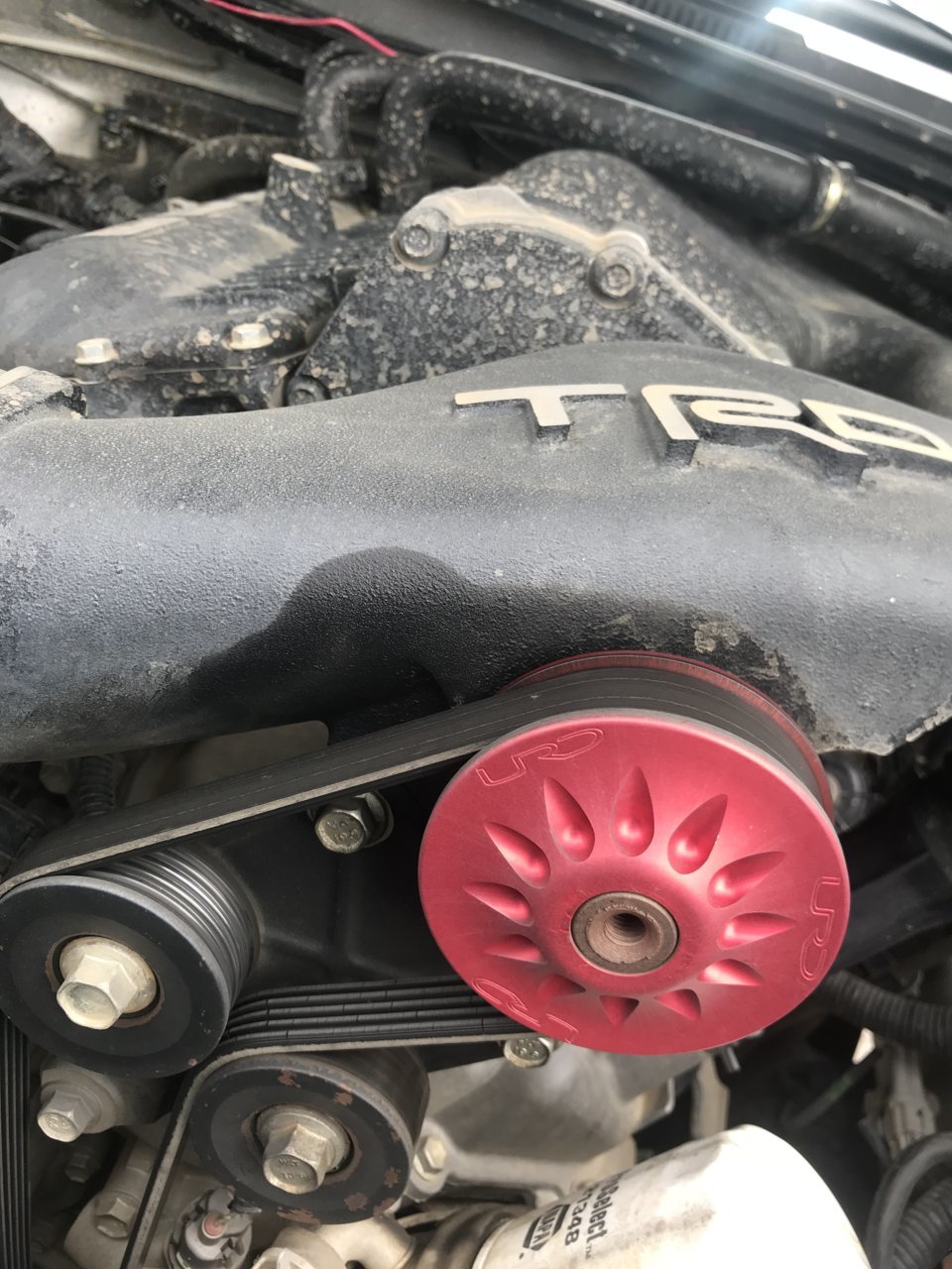

    I’m replacing the belts on my truck today and I pop the hood and it looks like I’ve got oil coming from behind the pulley? Has anybody ran across this before or know what I need to do to resolve this issue?

    Check the oil plug behind the pulley. Might be leaking.

    Do what you gotta do, clean it, then monitor it. If it continues then you may have a leaking internal seal.
