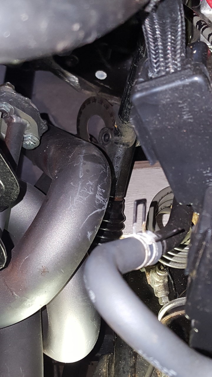

    I installed the URD headers without lifting the truck or removing the wheels. It took longer to remove the Doug Thorley shorties than to install the URD headers. My only hang up was the steering shaft clamp. I got it to move up enough to disconnect the shaft but it would not budge sliding back down to reconnect.
    The trick I used for this was to place a washer in the clamp slot over the bolt hole and tightened a bolt on the threaded back side of the clamp. This opens the clamp to allow it to move. Even then I still had to tap it down into place with a bit of force using a bar from the top of the engine bay and a block of wood keeping the two shafts in alignment.

    That steering shaft gave me some trouble as well. The LT headers are worth it though... for race purposes only of course.

    I got most of my header install done.....then realized the steering shaft was in the wrong place.
    Very frustrating. But yes, these headers are worth it.
