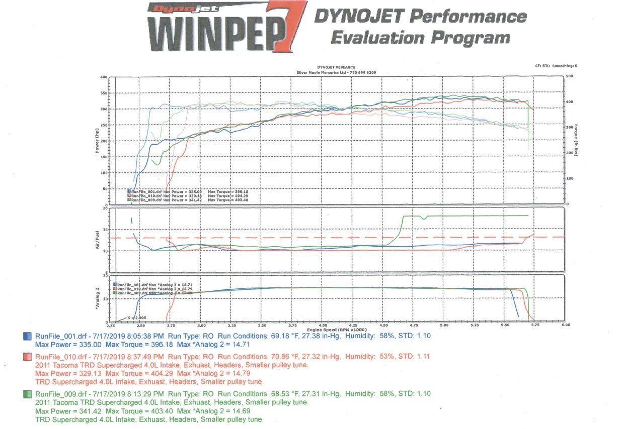

    Dyno results. I know I shouldn't feel bad about these numbers but it's confusing why my numbers went down since replacing the 2.0" with a 1.87" pulley and/or doing what I could to reduce belt slip. Torque is about the same as last time though, flat right around 400ftlbs until 4000rpm. Definitely a low-end torque monster.
    The sudden jump in AFR on the green run is because my exhaust blew off. Going to check this against the data I collected, I think I have a log for each of these runs.

    Did you log IATs? You really could be pushing heat earlier into the rpm range causing the upper rpm to not make the power that it used to.
