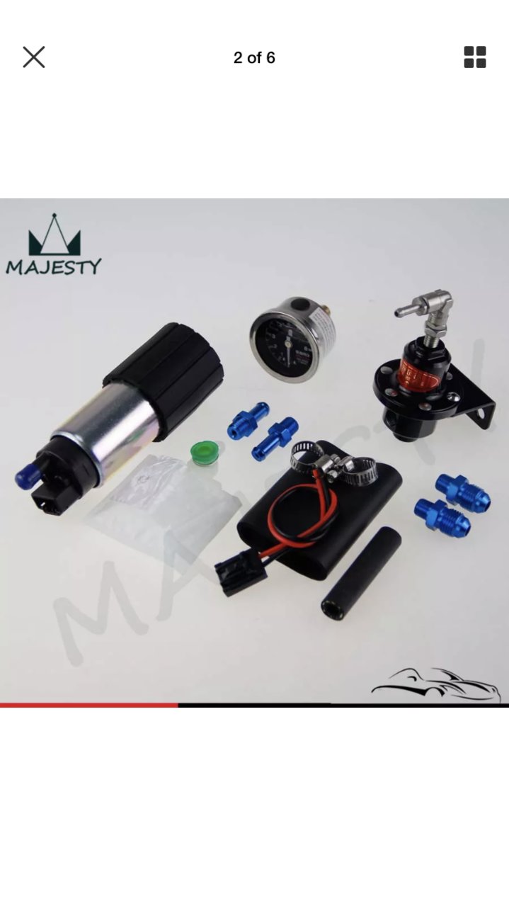

    A question please: when I change the fuel pump, do I also have to change the fuel regulator at the back of the engine to an adjustable one to allow more fuel in?

    Just the pump will do.

    Is there a reason why the fuel regulator doesn’t need changing? I’m assuming your implying that the stock one will still let in enough fuel?

    255LPM pump with adjustable fuel regulator.

    The OEM one will do well enough. Until you are needing to have a boost referenced one, with a larger diaphragm.
    Judging by that picture, I'd look for a better quality regulator, such as GFB, as well as make sure you get a brand name pump. Walbro etc...

    Ah ok. I’ll hunt around for a better quality pump. Thanks
