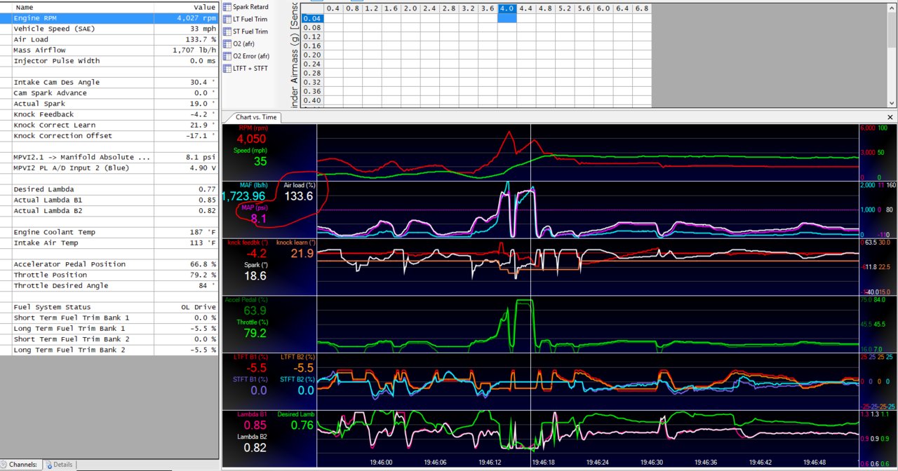

    My shit is all stock.
    At least we can actually tune our trucks now. I'm thankful for that.
    I wish I had my laptop with me. Use "air load" as your map sensor reading. I have that as well as a map sensor reading (via AEM 30-4900 5v analog output) they're charting together in scanner on the same graph. They follow each other pretty much exactly. I'll post some screen grabs when I get home.
    Like exactly the same for the most part...
