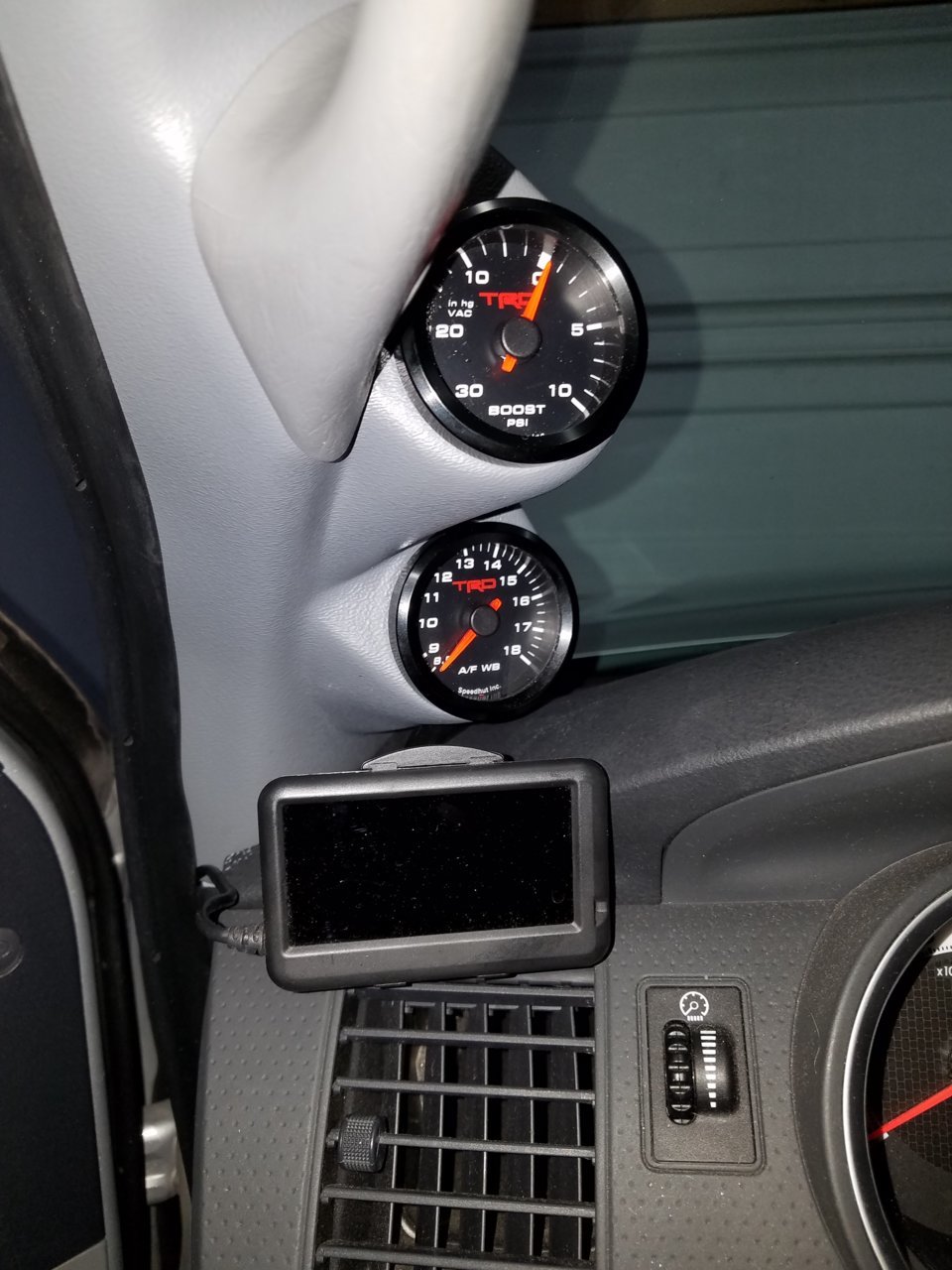

    Apologies for wandering back on-topic, but I installed an AFR extension harnesss from Ballenger Motorsports last weekend. Had a local shop weld-in the bung today - both gauges are now fully functional.
    (Changed out the black bezels for silver ones too, for better match with OEM dash.)
    No logging yet, as I need to upgrade to HPT Pro and figure out how to get the analog AFR signal into it, but gauge observation while driving home from the shop indicates
    - Stable (stoichiometric) ~14.7 when idling (~-17 - -15 in hg)
    - Stable (stoichiometric) ~14.7 when cruising (~-15 - 0 in hg)
    - Richening to ~12-13 under moderate throttle/boost (~0 - 3 psi)
    - Richening to ~10.5 at WOT/full boost (~5 - 7 psi)
    - Only time it goes lean is when downshifting, as expected

    Nicely done sir.

    How dare you wander off topic right now and keep the thread relevant?!
    But on a serious note, shhhhh....!!!! That's hot Norton! Good job brotha! :thumbsup:
