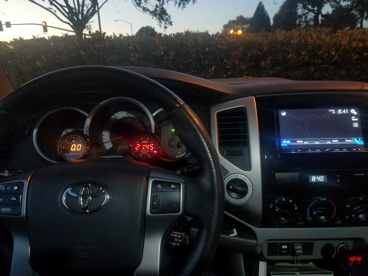

    Since everyone wants to play, my turn. Yes the truck is off.

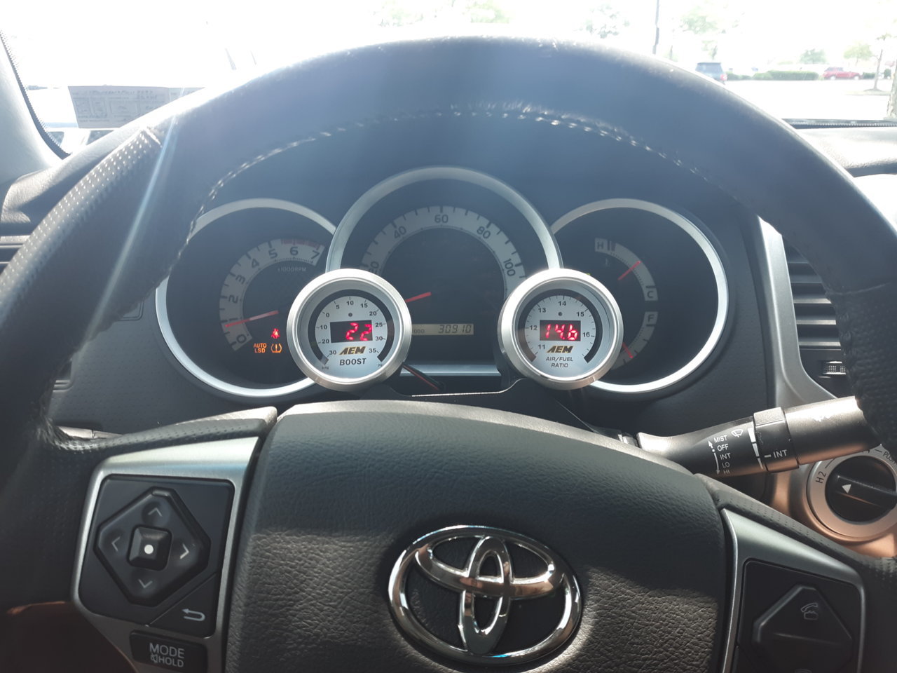

    Here’s mine. The ultra gage has moved slightly up and left a little
    This was also around the time my engine had spun a bearing. The oil pressure gauge confirmed that something was majorly wrong when I had like 5 psi at idle :rofl:o_O:(:mad:
