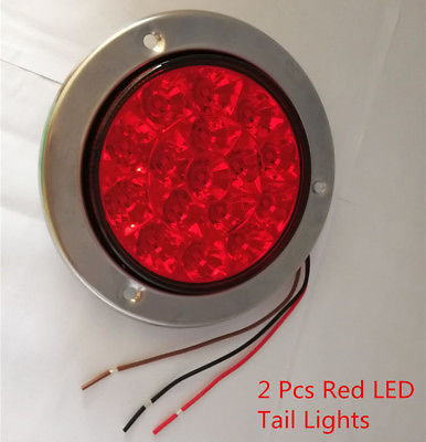

    I think I’ll just go for the blinking led failsafe. Now what’s a big bright led that I can’t miss to show I’m pumping meth?
    Kelvin[QUOTED] likes this.
