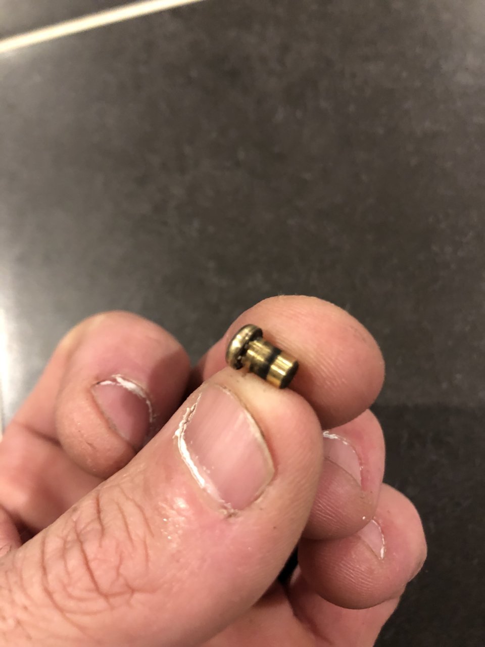

    Finally got this little brass fitting out from the bypass valve line.
    I noticed now that the bypass valve opens and closes extremely fast when I take off and put back on the vacuum line.
    Torspd likes this.

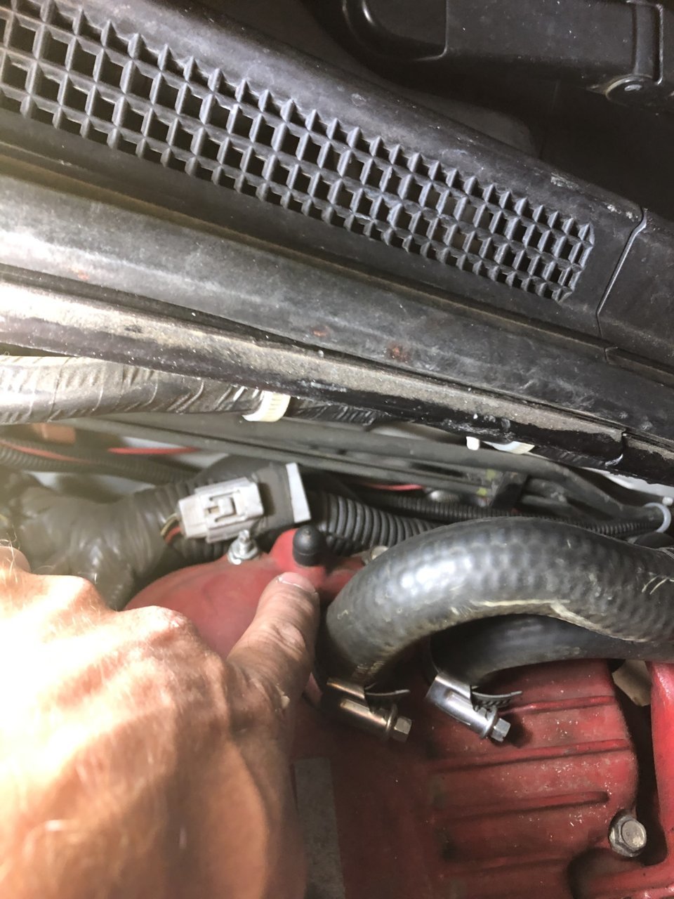

    Question: what is this vacuum port for? It is capped off. Just noticed it when I was taking off the other vacuum line.

    Also I did notice that I could get the boost up to 3800-4000rpm after I removed the brass piece.
    Is that normal?
    The boost is still not as good as it is when I take off the vacuum line. With the vacuum line off I can get boost all the way to red line.

    That port is where my boost gauge is hooked up. Also where you can tie in the hose from your fuel pressure regulator to boost reference fuel pressure

    Got ya! Thanks for that. I was also considering getting a boost gauge so now I know where it goes.
