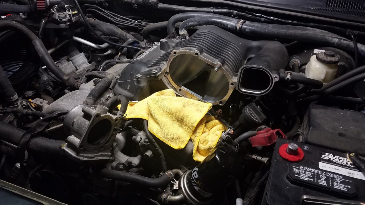

    20190804_200623.jpg Going in to do the retard gears... started the teardown tonight... got the supercharger off and the intercooler. Valve covers tomorrow.

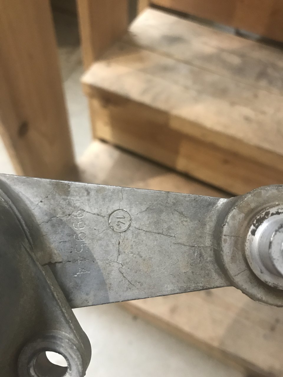

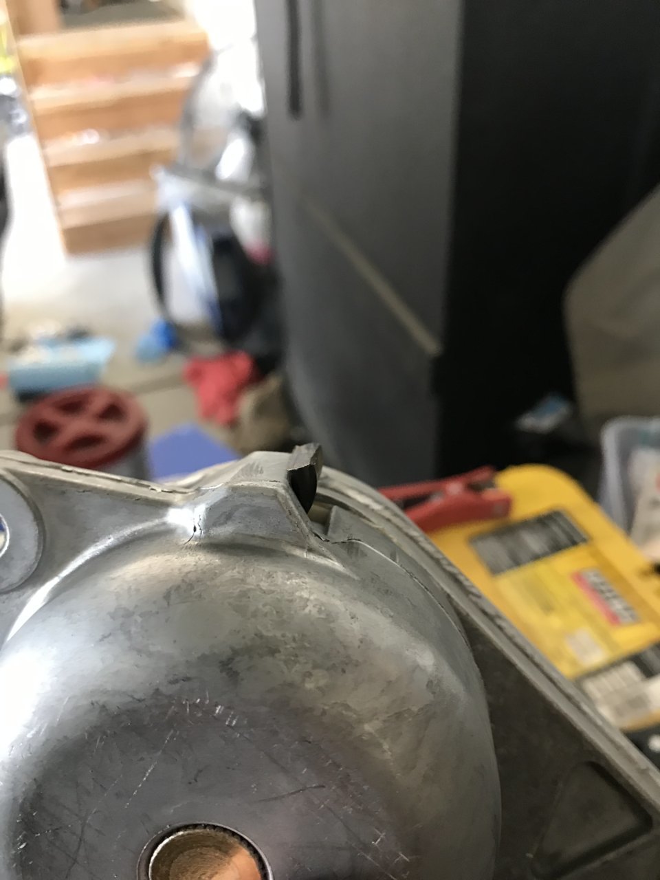

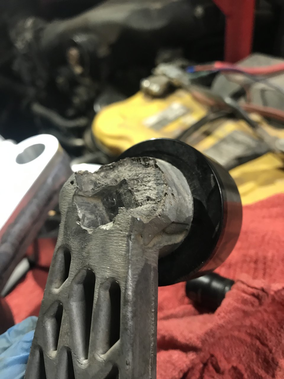

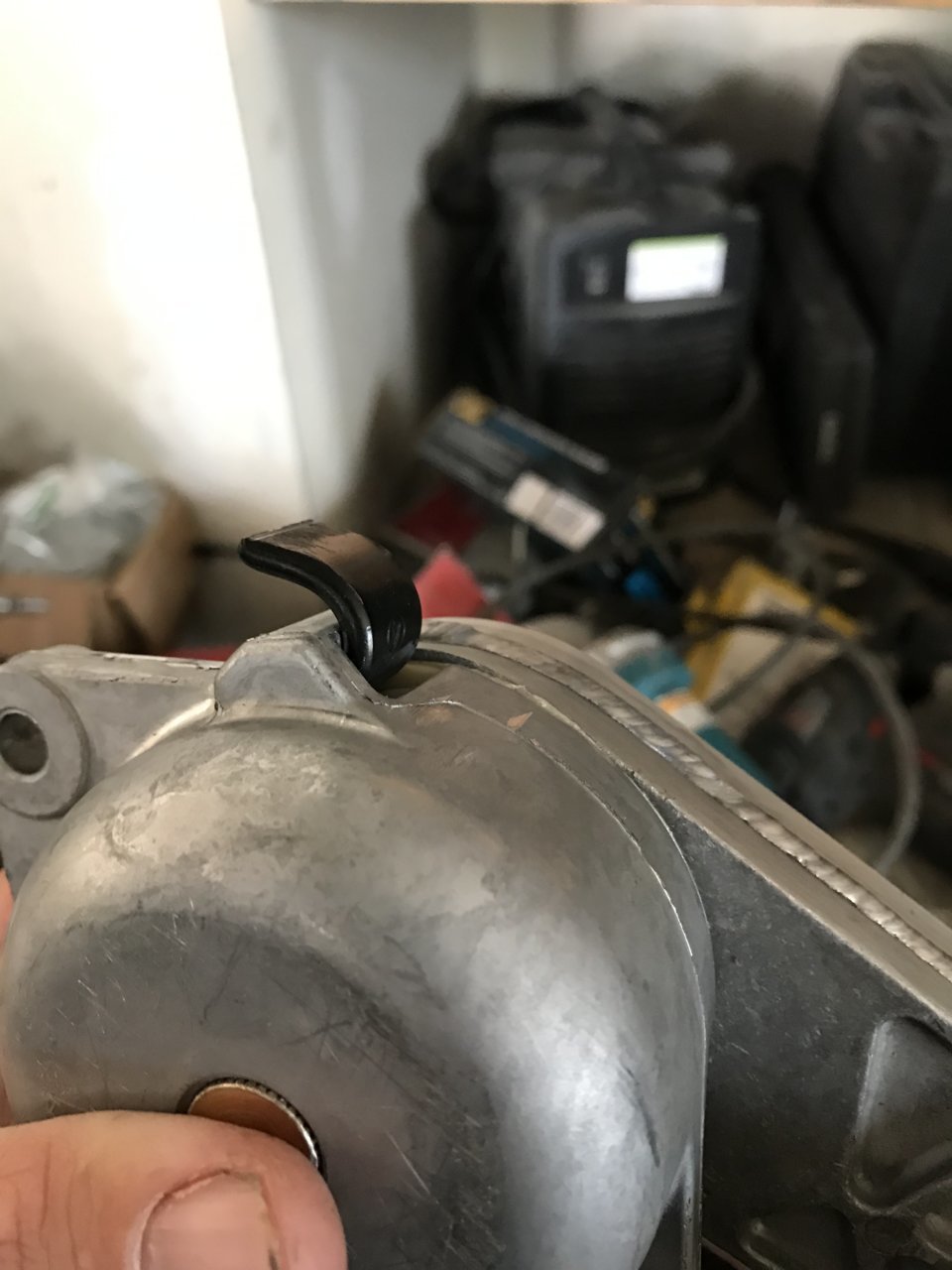

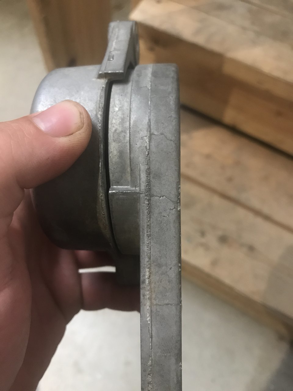

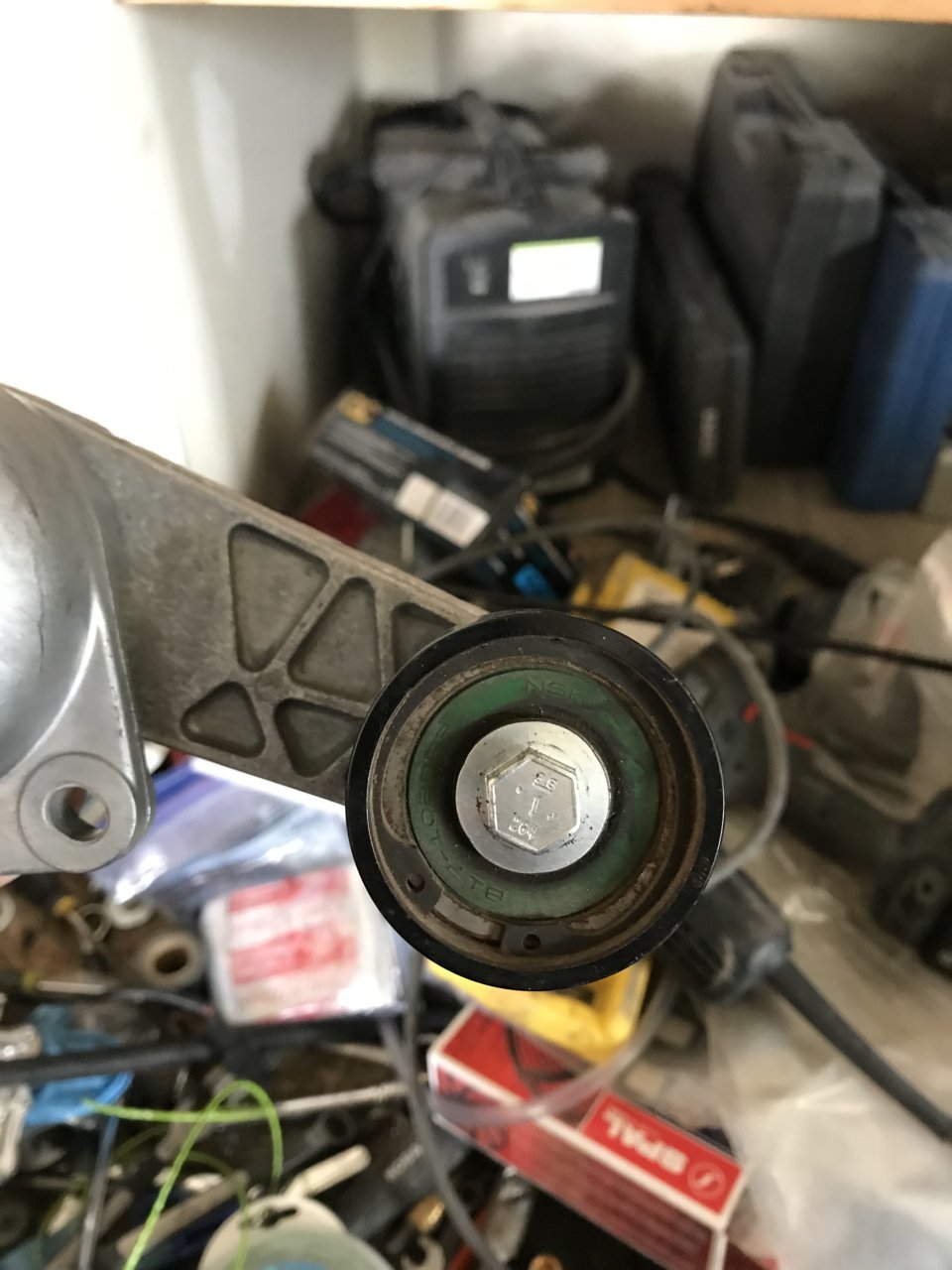

    Side note to anyone looking at replacing their tensioner....do it. Mine broke awhile ago, not in a catastrophic way, but in the slot that your ratchet goes into to crank the tensioner.
    I finally replaced it with the reinforced Steeda one linked in the original post. When I got my factory one out I examined it and found multiple stress cracks in the arm.
    Some may be from casting but some are definitely from stress and would likely break. I also was able to remove my belt by hand when I swapped it out because the tensioner spring in it was so loose.
    The Steeda is much stronger. However the one linked in the first post was not a direct fit for my truck. There is a small tab that holds the tensioner spring in place. On my truck it stuck up too high and hit the bracket that holds the tensioner assembly in place. I trimmed it as shown below and it fit fine.

    Seriously, those bolts and nut do not need a torque spec because RTV doesn't care what torque you tighten bolts or nuts to. It's going to form a gasket no matter what so just get them tight, let it dry and forget about it.
    It has become a previous known fact that all the aftermarket upgrade tensioners require some form of small modding here and there to fit to our setups no matter the brand. Great post, but this has been discussed in detail in prior posts.
    There is no true "bolt on" upgraded strength tensioner for our trucks, but they are close.

    Would you go with the roush or steed tensioner? I think it will be good to get this out of the way in the beginning.

    Can the original post be updated with that info? I know it talks about the Roush tensioner mods but nothing is mentioned about the others. I can’t say I have kept up on every post in the thread but I do follow pretty closely and I never saw anything about the Steeda needing modifications. It wasn’t a huge deal to trim at all but the info would be nice to know upfront.
