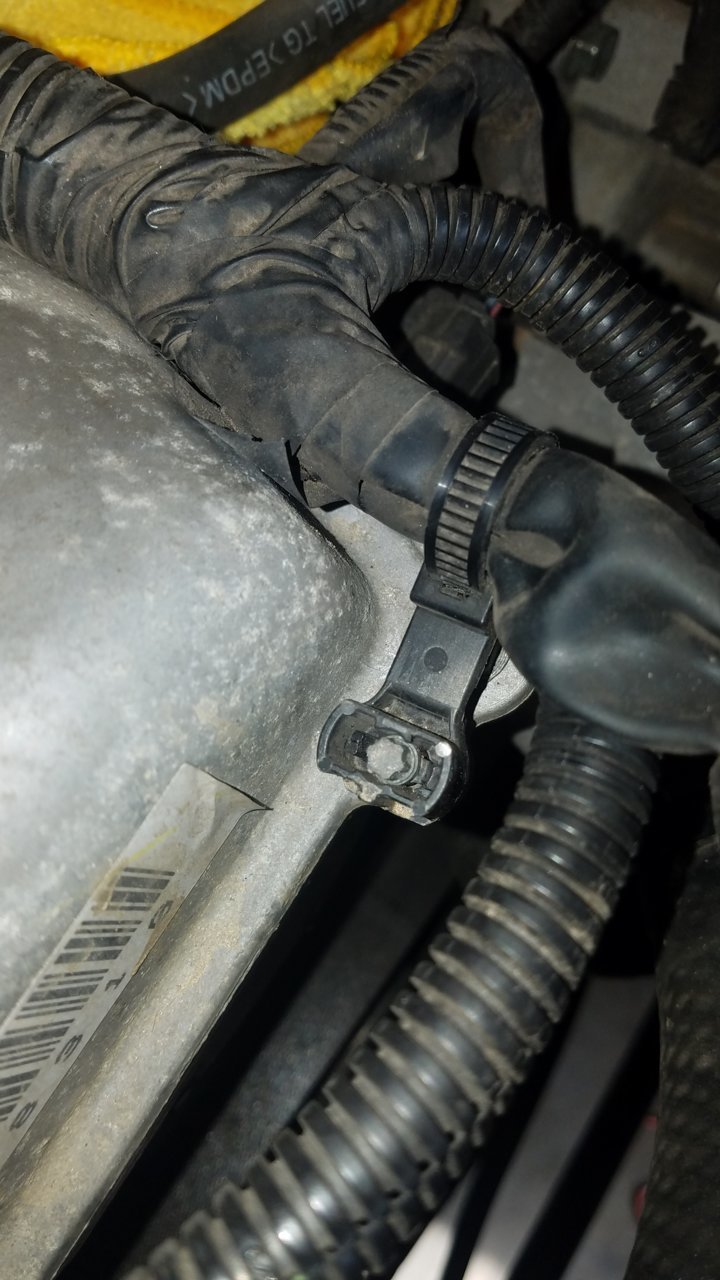

    Pull harder!.... or stick a pick in down the side of the stud....

    That's what I was thinking.... but these clips break so easily.

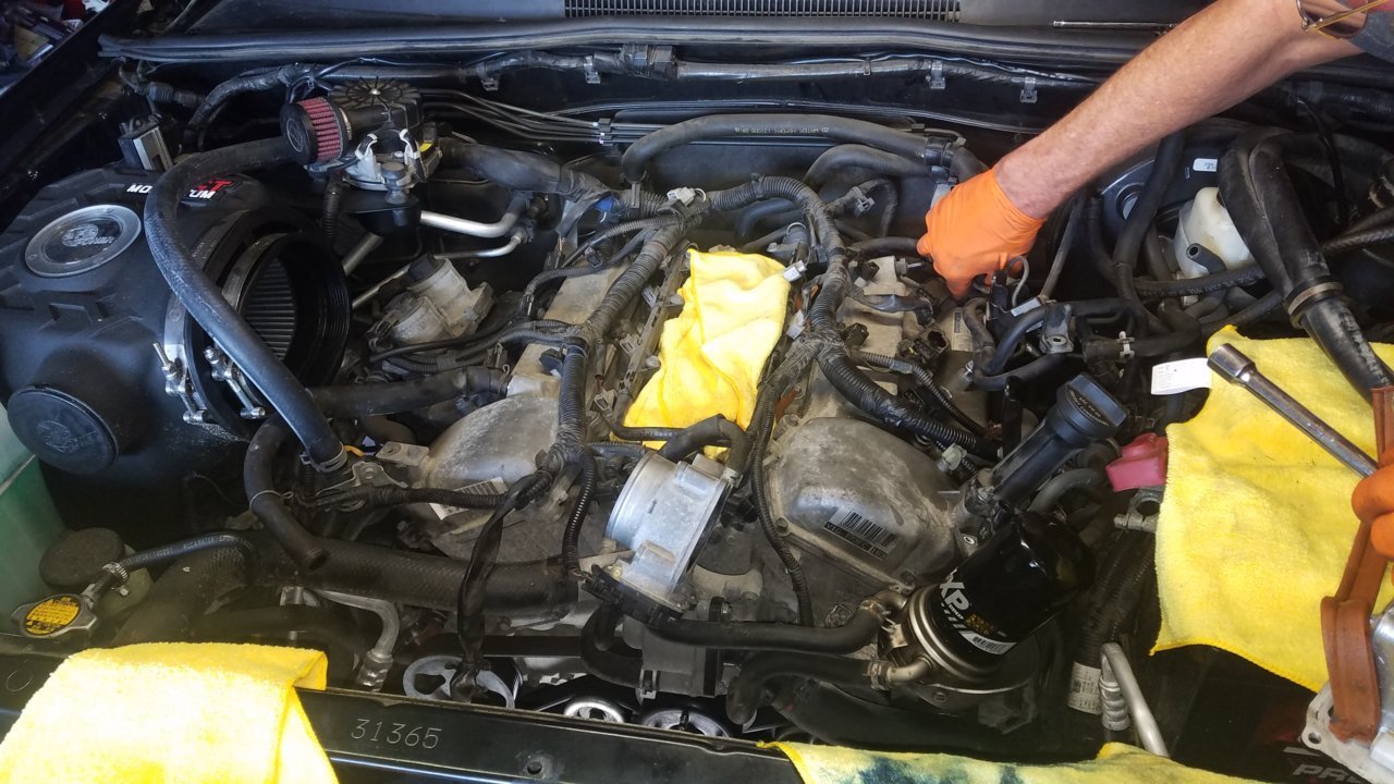

    20190805_093127.jpg It looks so sad without a blower...

    You gonna paint the valve covers before you reinstall? It'll turn that frown upside down.

    thats an intense instake. AFE? Running it with a snorkel? Thats my dilema on running one or not.

    Snorkeling can be an intake restriction I understand.

    255 will be enough. I still have it and have no fuel delivery issues at 440g/s going through the MAF.

    That's the new AFE Momentum, it's so big you have to uninstall the SC to change the filter.

    savage that prob would not work for me. I change that thing too often.
