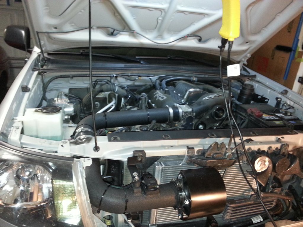

    Pretty sure all i did was flip that bracket upside down.... the 1 nearest the filter.
    I just woke up and am a bit groggy tho
    Yeah, this is the way gadget has u install normally....

    This is how mine was attached.... its been awhile and i dont have the urd anymore, sorry...

    I assume all of you cut 1.5-2” from the TB connection also

    I did not cut any of the tubing at all.
    Prolly woulda been easier.
    I cant recall what for sure, but i think i had to alter the cutting template a little.

    Yes, about 2". You have some adjustment with the couplers. You could just set your stock manifold on top of the sc when you get it off to see exactly how much the sc moves the tb over but just cutting 2" is fine.
    For the front bracket I just bent a flat 2"x4" piece of sheet metal into a 90 degree and drilled two holes. One where it mounts to the body and the other to the intake.
    I get where you are coming from and want to have every avenue covered prior to install but there is really no need to over think some of this stuff.

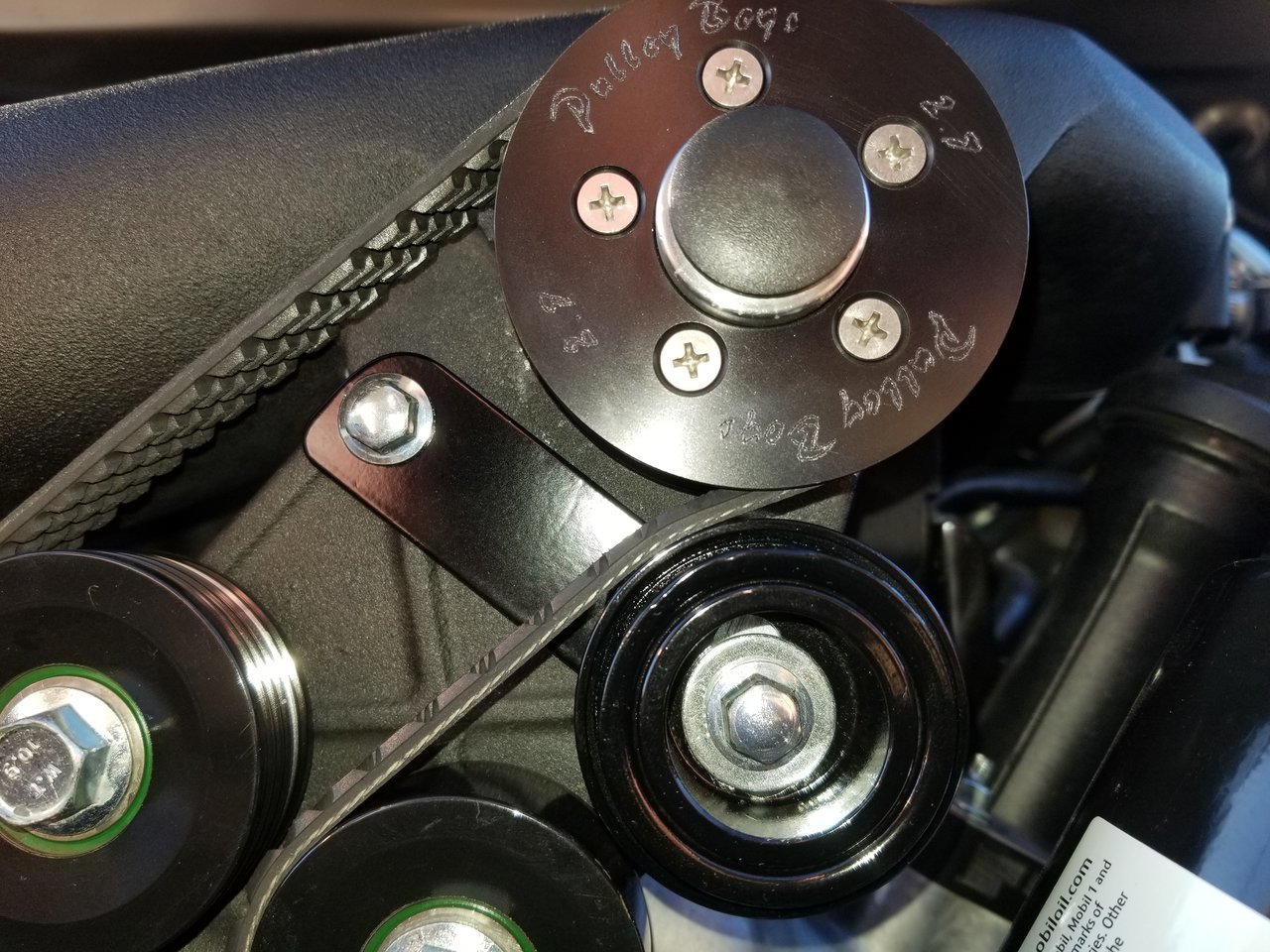

    That looks interesting. Let us know how it does and if you notice improvement.

    Works great. No real improvement so to speak as I don't red line the truck daily but I won't have to worry about slipping belts and boost loss.

    What screws are those? My were allen head, and I lost one :(

    Stainless Phillips screws I got at the local hardware store. I don't remember the size offhand, I just took one with me and matched it up.
