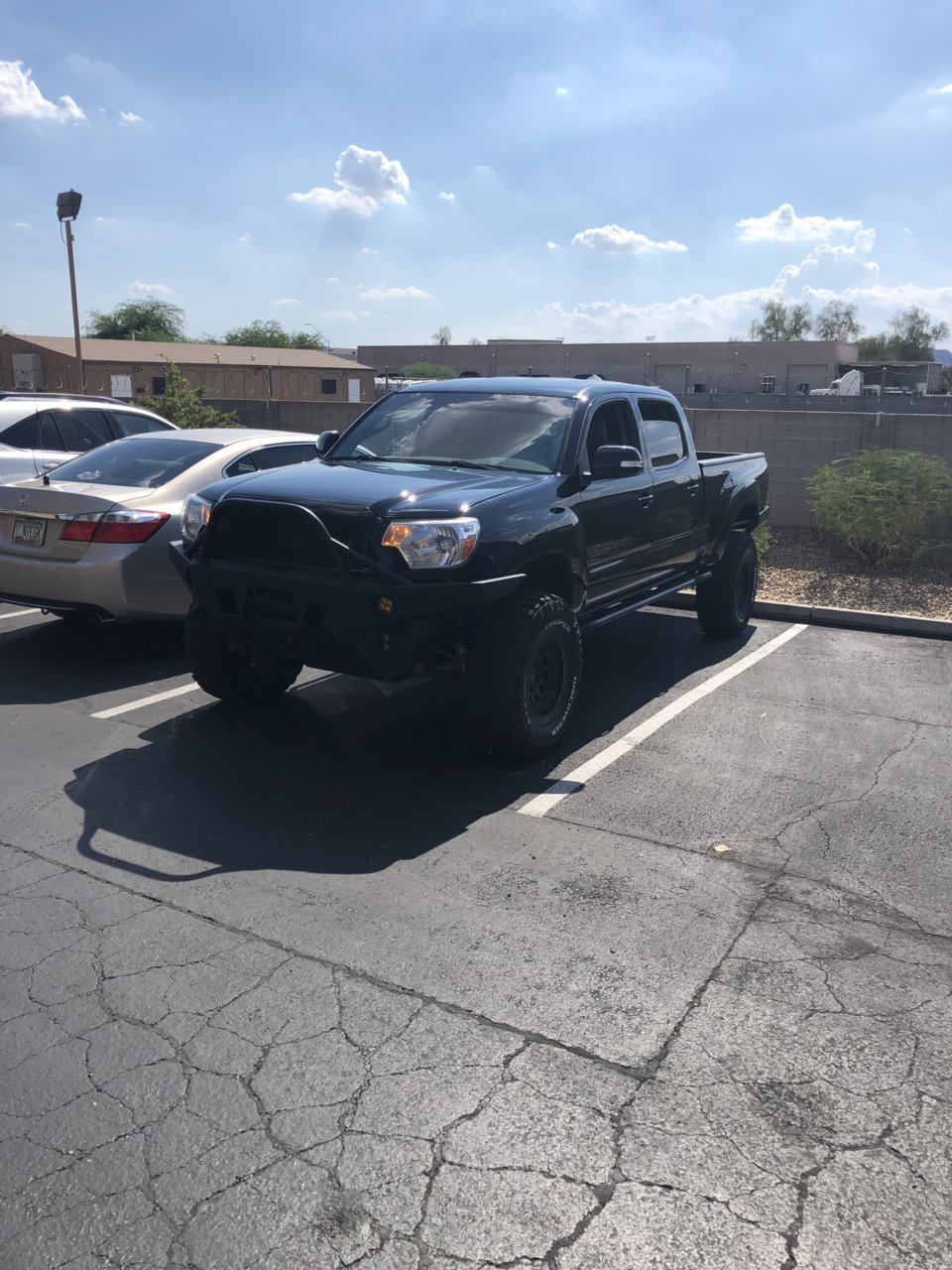

    How obstructed is your radiator? Meaning how much stuff is in front of it?
    The hot air also needs a place to escape so if you have skids, larger wheel well covers, etc then airflow will decrease through the radiator because it doesnt have a good place to exit the engine compartment.

    Just my bumper and a skid. At around 95 ambient I never go above 190 for comparison sake

    Sweet bumper!
