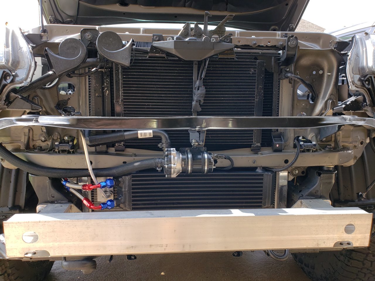

    The engine temp sensor is in the back of the motor after the coolant has transferred the engine heat so it is reading the hottest temp.
    When you reved the engine you also spun the pump faster which pulled more cooler fluid from the radiator.
    That is why you see the temp change.
    Yes there is a lot of stuff in the way of clean airflow through the radiator which is why my front end looks like this now.
    Horns are moved.
    Intercooler pump moved up even with brace.
    Factory trans cooler removed
    Big ass CSF cooler installed with a thermostat for temp control.
    Sterdog, Norton, Torspd and 2 others like this.

    Is that the prototype csf we were talking about?

    Can you undo a couple clips and zip tie the splash guard partially out of the way?
    Murphinator[QUOTED] likes this.
