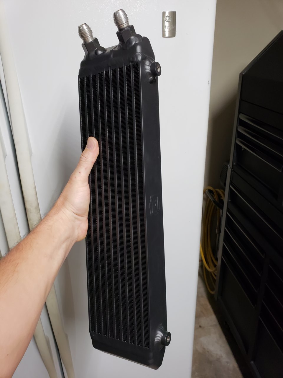

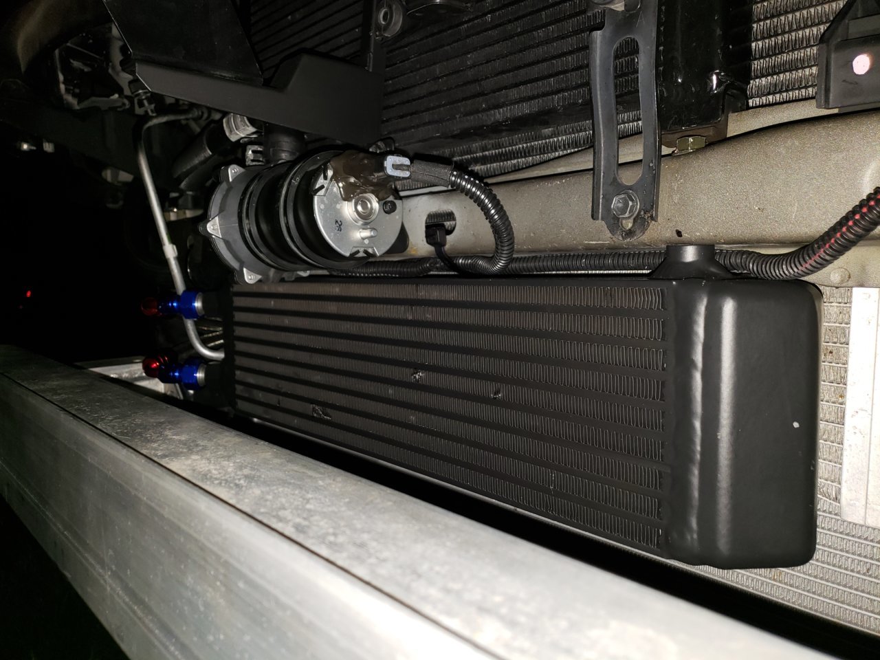

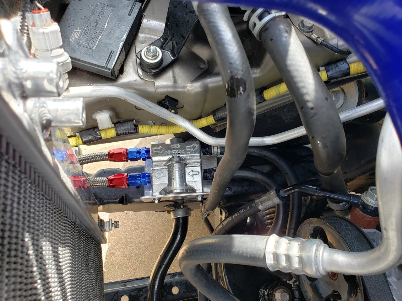

    Let me find the specs. I got it from CSF to try out for our trucks after the success they achieved with the radiator (wonder who made that work) :D.
    Right now I have also bypassed the radiator so the trans cooler is the only thing keeping the trans cool.
    The thermostat is a Derale unit factory set to 180°. I havent done any real loading of the trans (no mountains in Wichita Falls) but trans temps have been about 165 to 170 just around town.
    I will probably route the fluid through the radiator again for safety sake but I wanted to get rid of as many extra lines and brackets as possible.
    Currently the only potential problem I forsee is when it would be colder out. Right now in summer my Efan is running with the ac which keeps the trans cooler cool. In cooler temps where ac is not needed the fan wont run as fast so sitting in traffic could cause temps to rise. Routing the trans fluid through the radiator will alleviate this potential issue.
    Here are some preliminary pics.
    Its mounted to the cross brace.
    Homemade bracket holding the Derale thermostat.
    Routing is trans out, thermostat, cooler, thermostat return, trans in.
    The cooler is expensive $350! But it is built like a tank! It is made to be in front and handle rocks and such. It weighs probably 4lbs!
