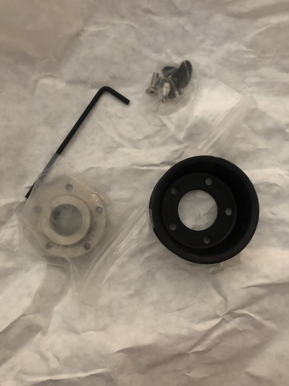

    So test drive after all the work. I cant mash about like I usually do due to my clutch about to give up, so Grandma driving only. Still, what a difference! I dont know if it's from the fresh spark plugs or the retard gears or both, but my engine runs wayyyyyyyy smoother. Idle sounds and feels better, down revs are happier sounding, and its not as ragged feeling all around. I picked up .3 - .4 on the AFR gauge richer, which would make sense as more fuel is now in my exhaust and not being kept in the cylinder for a communist re-burn. The poly coupler is money. Call it a butt dyno feeling, but I feel like the supercharger is THERE now. Like on standby to jump in as soon as my foot hits the gas. More on that when I replace the clutch and can give her the beans. The OEM spring coupler was making little gouges where the little spring feet make contact, so I'm glad it's out if for no other reason then to stop the damage. I played with the blow off valve for a hot minute, and it seemed to be making solid contact and closing well as is, so I didn't touch it. It was making happy little tinking noises everytime it closed. It was a full day of work, but so far very much worth it.
