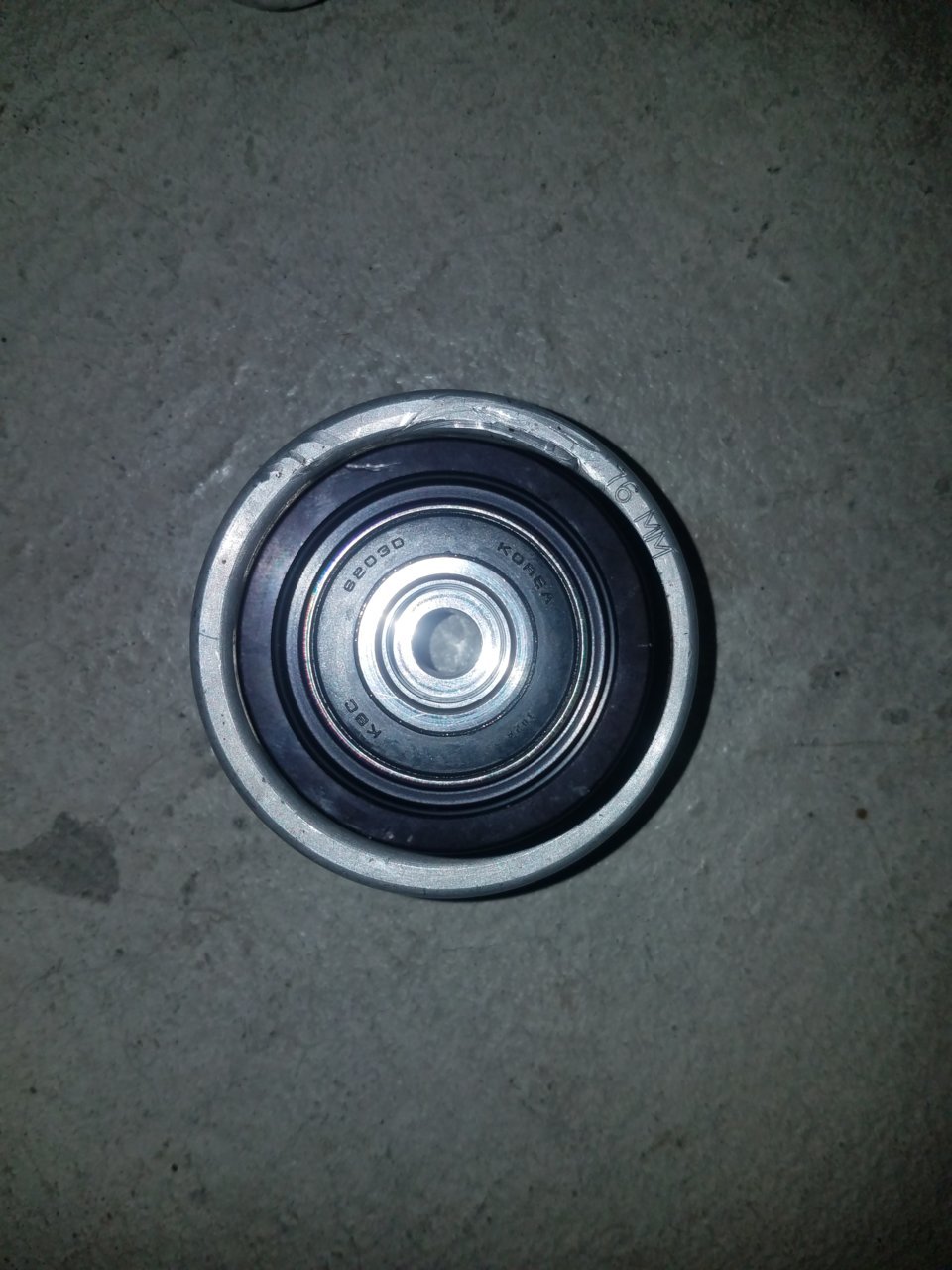

    I think it might be the belt.. i dont have a wrap idler installed, so i think its gotta be something else. I did notice when i had the tensioner off a while back that the idler pulley had a couple of spots in it while turning it that were a little harder, so may be time to replace that. Got the timkens in the mail today, so next time i change the belt, ill swap that out as well..
    Sell me on this 50mm. Whats the advantages of this over the stock one? Really want to avoid grinding on the tensioner, the weak points on the stock one is why i went with the roush. Not sure i trust myself to grind it down correctly lol

    It's the belt my man. I promise you it is.
    But just to reconfirm with you.. yes it is a 6203 bearing.
    Because these dual bearing rollers give the idler system as a whole added stability. You will notice a more consistent boost number while it is engaged assuming the belt is in good condition. I gotta replace mine too.

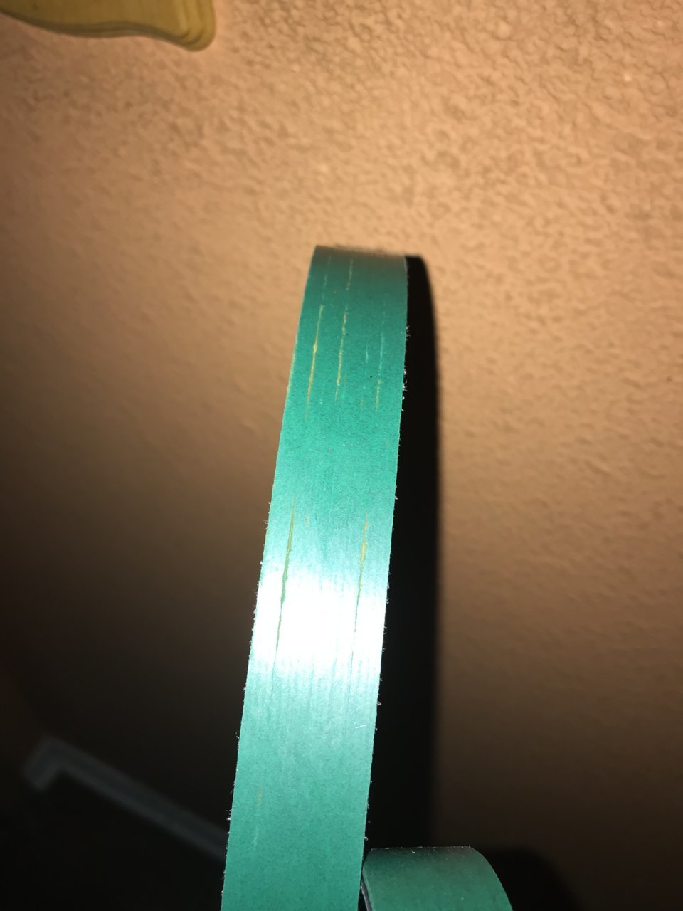

    Probably is the belt, but man i just swapped that thing out 2500 miles ago. Maybe i didnt cut it perfect

    Whats yalls thoughts on running this belt? The ribs look brand new but the back side not so much

    Oh no, then you are good. You should be good for the belt.
    Spray the system down with water while it is running if the chirp goes away the belt is the issue. If it does not it's a bearing issue.
