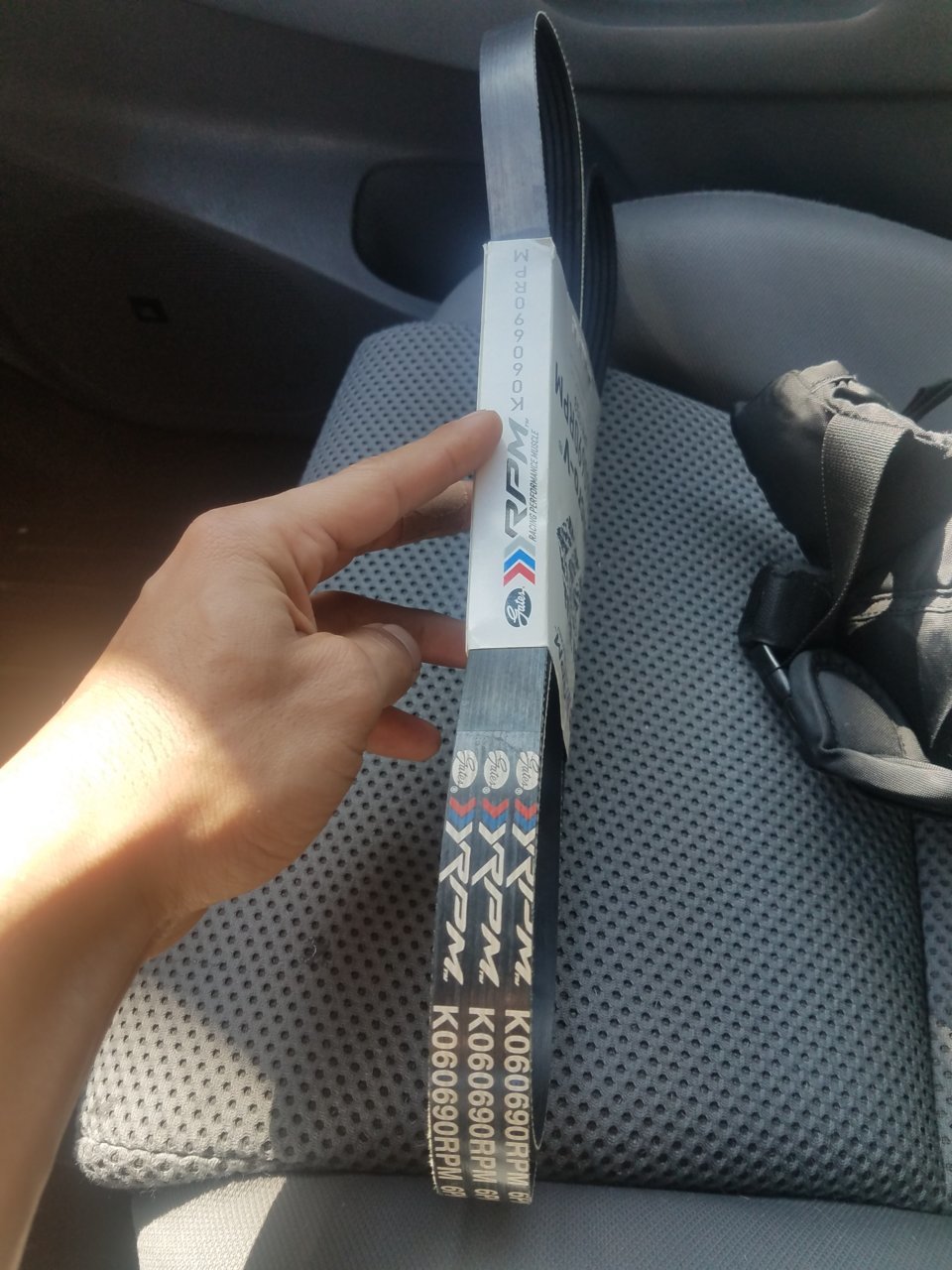

    That's why I'm saying if you want to save money on 80 mil just use Blueskin instead. One roll costs 20 bucks or so, covers 18 sq ft. And does the job just as good.
    K060690RPM. 69" same size as my Fleetrunner one.

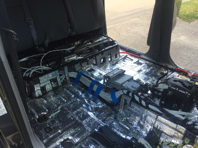

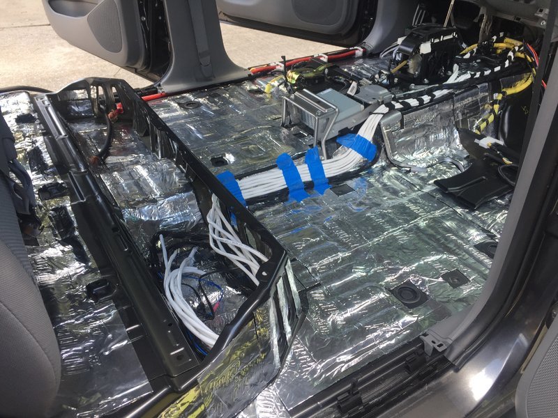

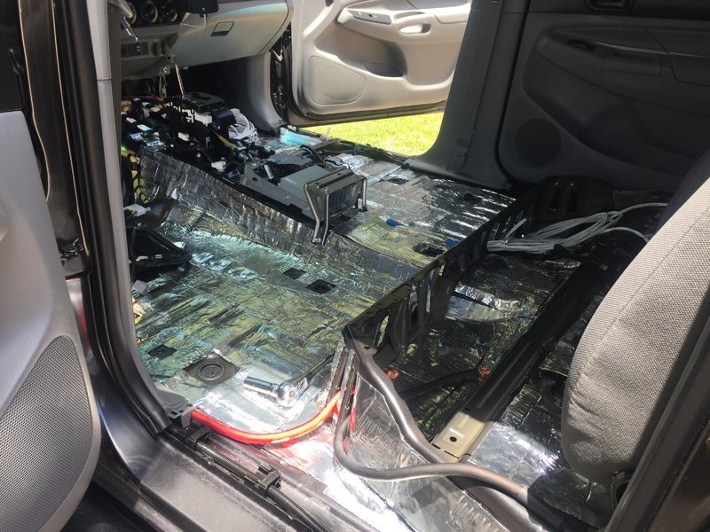

    I think maybe you saw mine already, but in case you haven’t I did the entire floor, the back wall and the front doors with three different layers.
    Roadkill Expert
    Roadkill Overkill Foam Mat
    Roadkill CarpetPad (not on doors)
    It made a difference in tire noise and road noise. Not sure about exhaust because I think I did it before I added louder exhaust. To minimize blower whine I think you’d have to do the firewall. I was thinking about doing the firewall if I ever have to replace the evaporator.

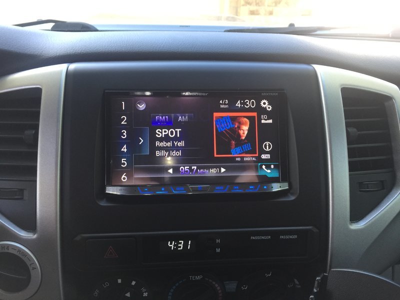

    Honestly if you want to subdue some blower noise (this goes for the dudes with solid poly coupler) I would say the quickest, most effective mod for noise suppression should be done at the hood. Just add some deadening around it, not even all over it and it should quiet down the rotor noise at idle. I may actually do this to the hood once I get some more sound deadener.
    Nice headunit BTW! Pioneer 8000NEX?

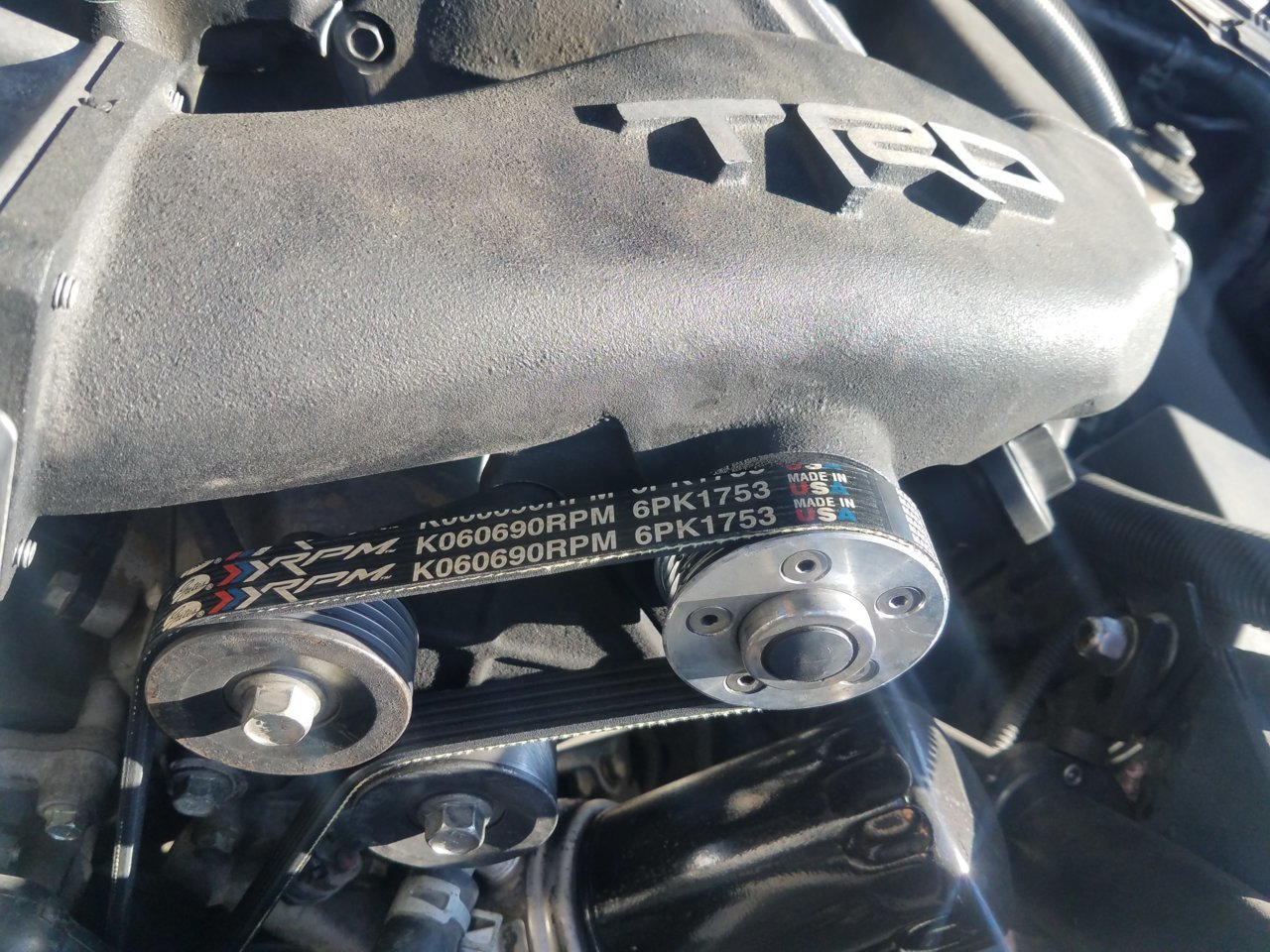

    Finally made the leap from standard to Fleetrunner to the RPM series. My squeaking at idle is now gone while in drive or reverse. Finally! The only drawback is that since the belt offers virtually no give whatsoever the rotors have gotten notably louder at idle. Worth it though. Engagement in general feels much better now and boost feels, "tighter" for lack of better words.

    Looks like you had to cut a rib off that bastard

    Unfortunately I did. I hate doing it because I always want the cut portion dead straight but I think with a little time with the truck on and a piece of folded up 80 grit should get me nice and straight.
