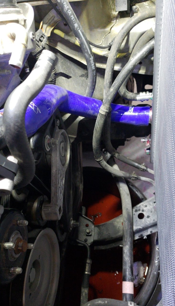

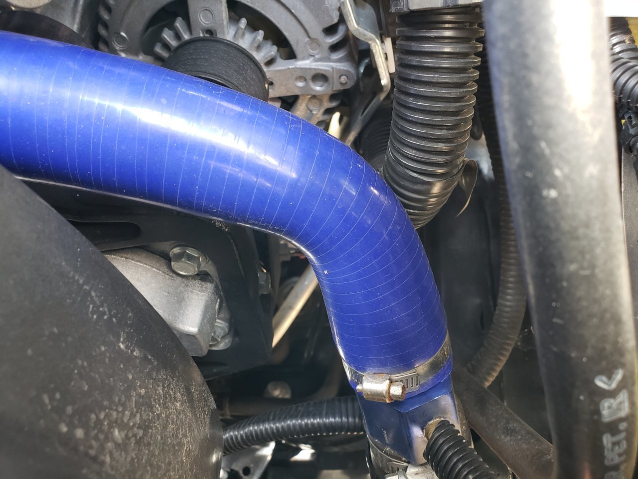

    113BBC52-0ADD-4A88-9B0D-028111AD7342.jpg 9B3D5553-1F35-4E77-9A15-A6BAEE703FC2.jpg

    quite a snug fit on that bracket.

    Thus the reason I didn’t use them. @Roostfactor did want them and we struck a deal. He has more room because e-fan.

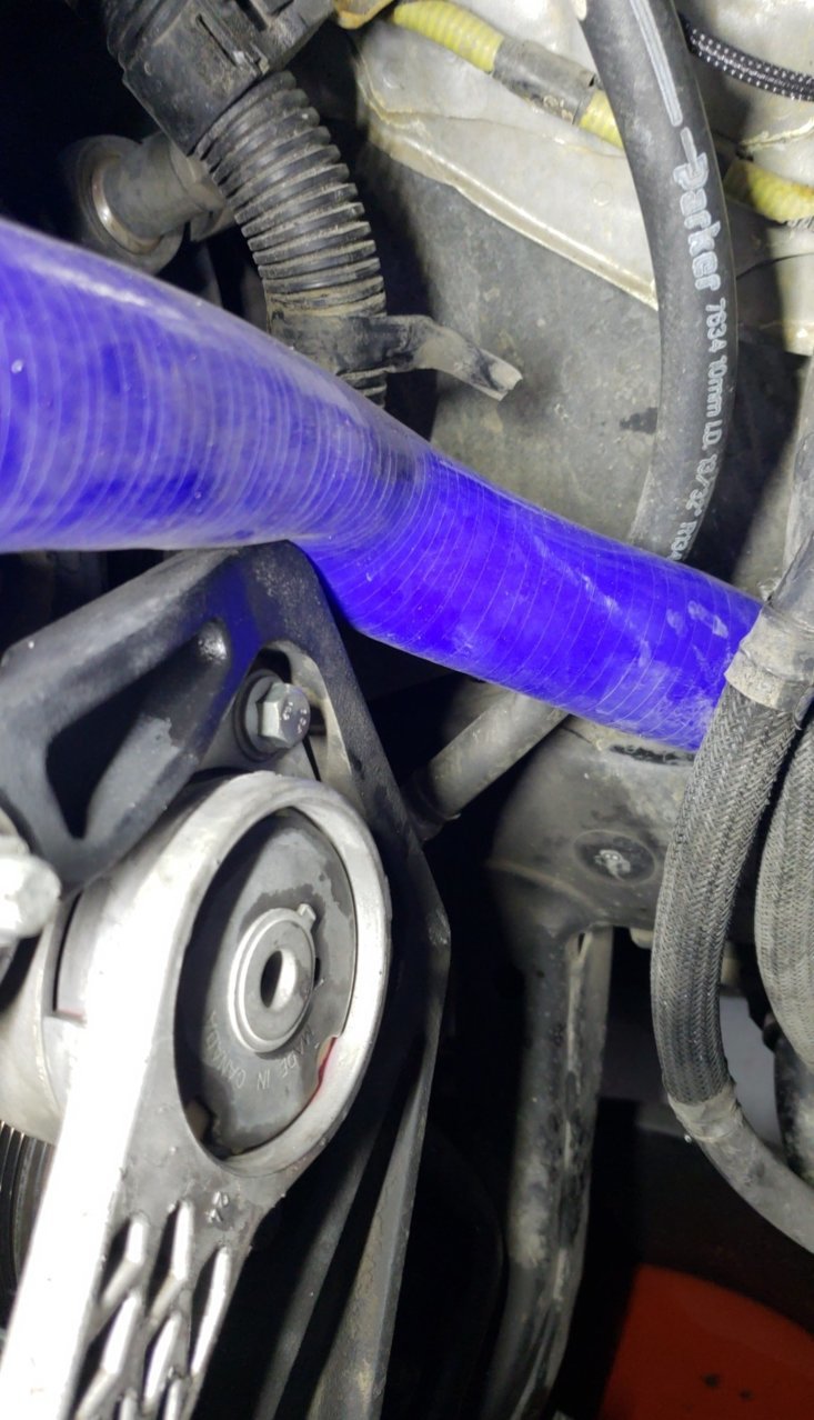

    For my fan controller the temp sensor must be on the radiator outlet (cold side) so the controller regulates fan speed compared to radiator (outlet) temps.
    It is a pwm controller so the fan only spins as fast as needed. I'll take a pic for you guys.

    Actually less room but it works.

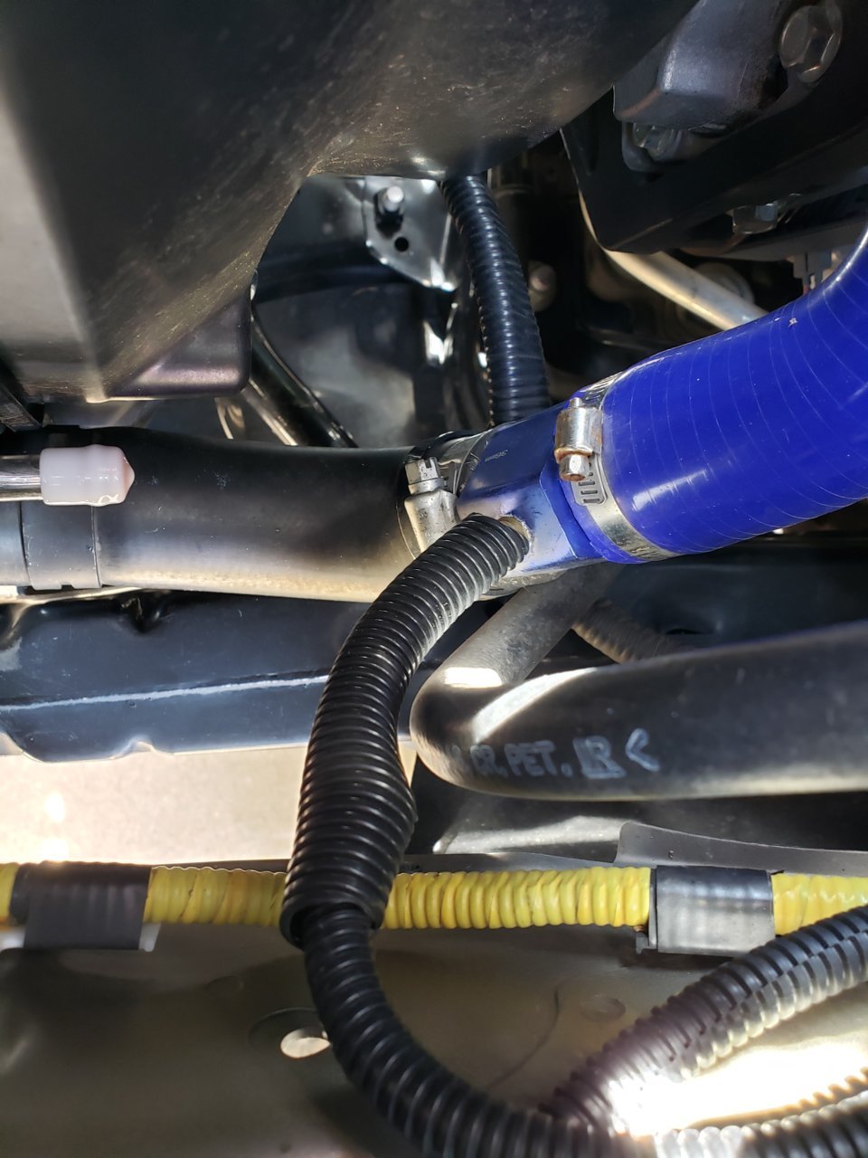

    Stock hose/temp sensor/HPS hose.

    did you trim your hose clamps? or just buy the perfect size?

    Shoot I dont remember buddy. I am ocd though.
