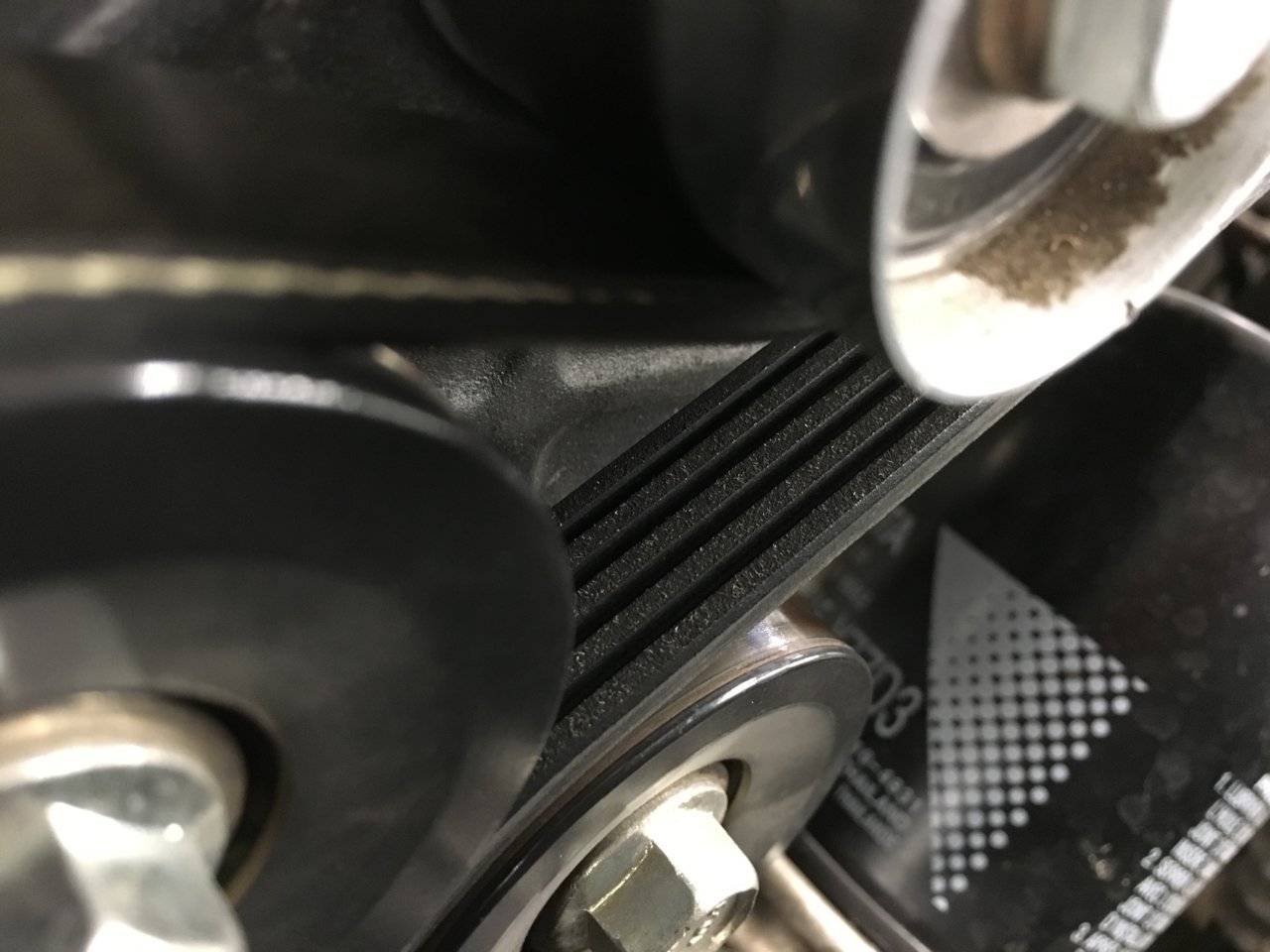

    Required cutting and I don't know. I'm also running @Roostfactor's pulley wrap mod.

    It should, just check the adjustment range on the tensioner after you install the belt and wrap mod.
    There is an indicator mark opposite of the tensioner arm. You want that indicator somewhere around the middle to allow movement in the tensioner arm.

    I am using the Dayco 6080695 with cut ribs but may try the Gates RPM belt at next change.

    I've got about 5k on it so far. 2.5 pulley and Rousch tensioner with my home brew wrap. Belt still looks good.
