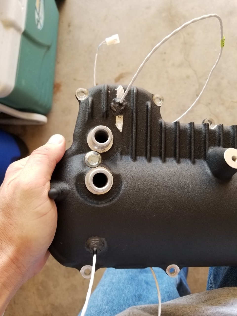

    I have an intake temp sensor gauge to be installed soon - can you take a picture of where you installed the thermocouples?

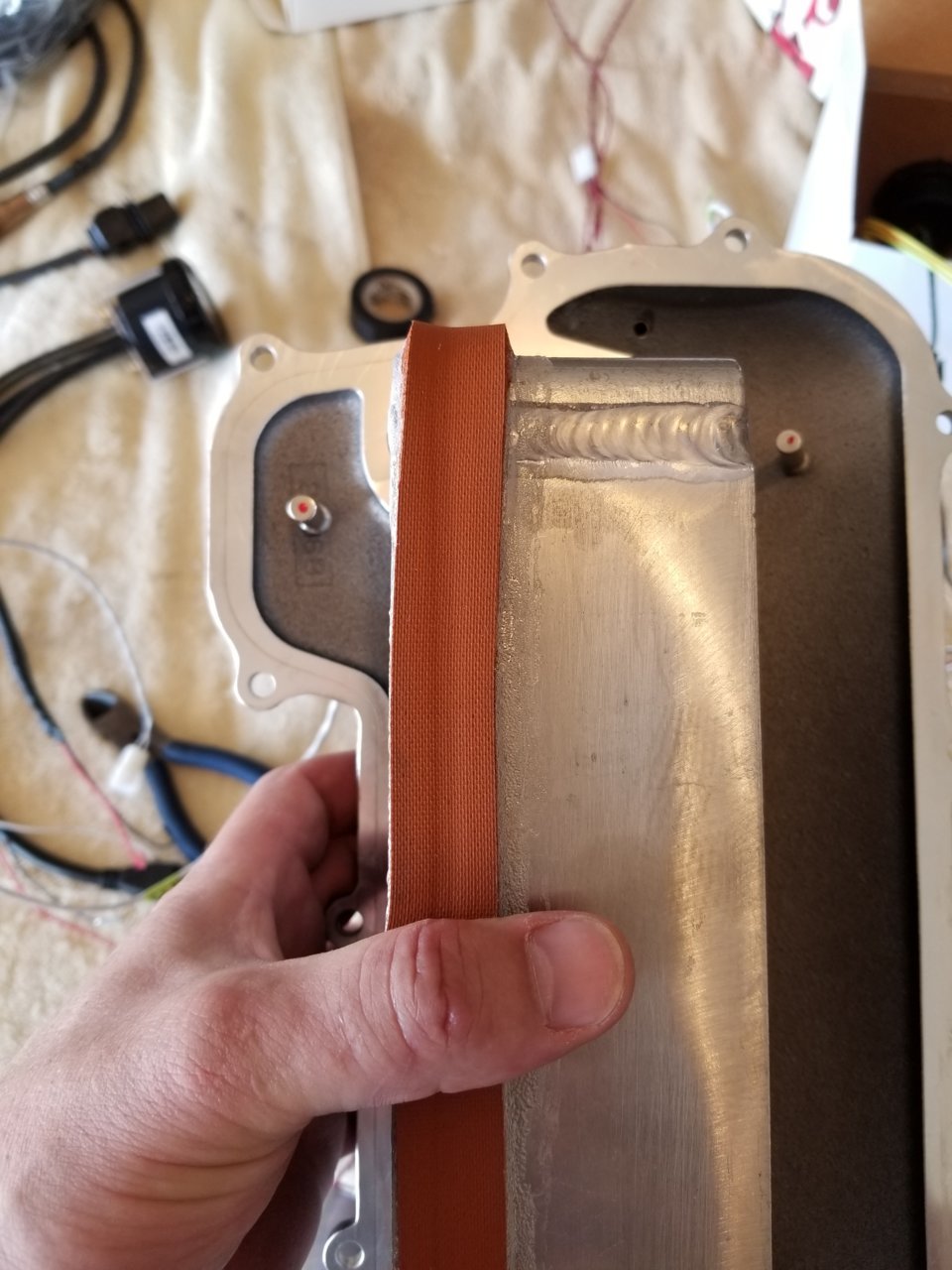

    Sure buddy!
    Here is the inside
    Here is the outside.

    Nice. That's better than the spot I had originally selected. Good thing I asked.

    Well I want to put one before water/methanol injection, so that'll be on the intake tube before the throttle body. The other one was going to go on the manifold itself, on the very front, right underneath the intercooler plate.
