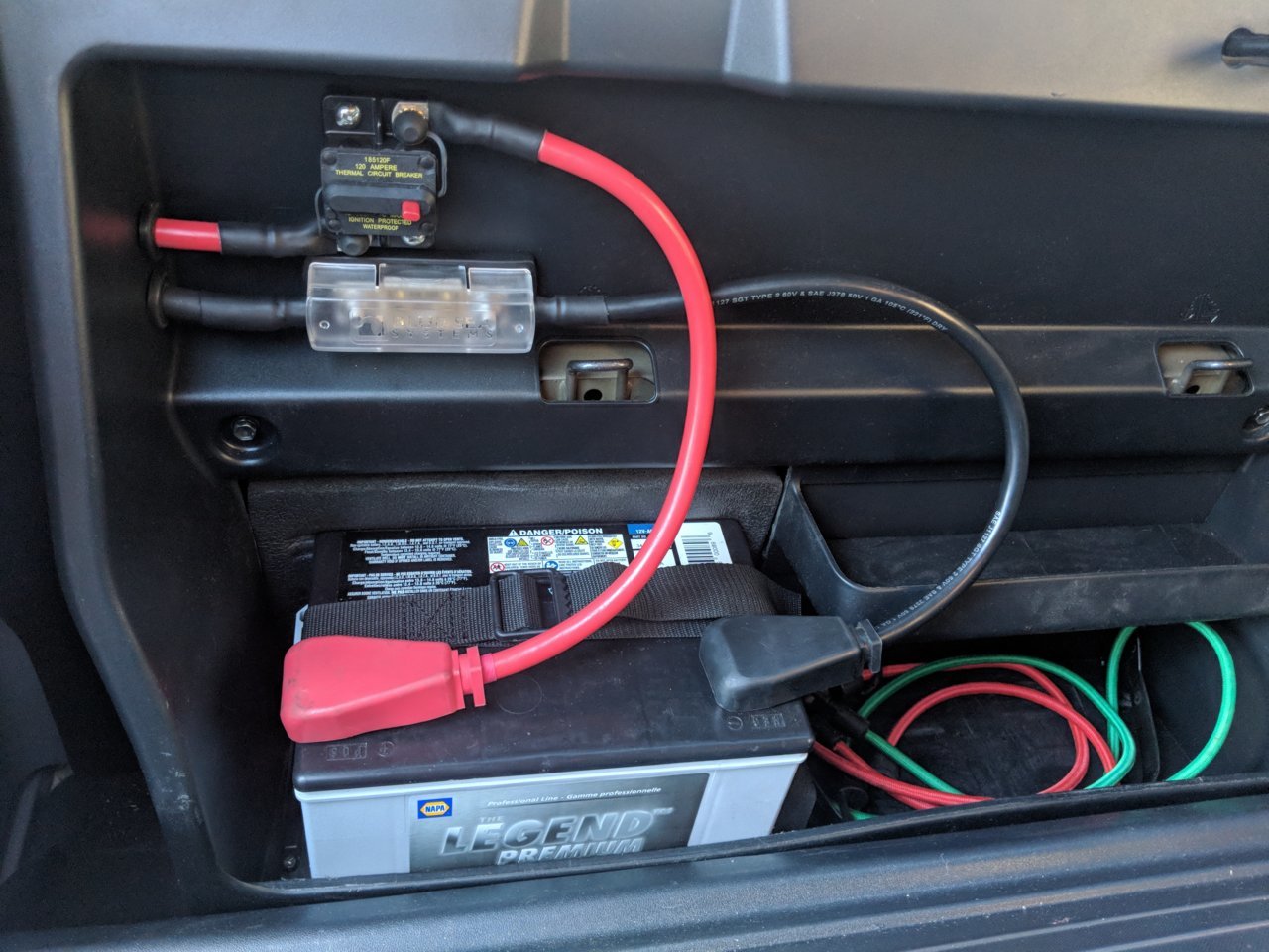

    Lucky you man short circutis are no joke, especially when you are shorting directly at the battery! :eek:
    Those reset breakers are SO useful when it comes to that stuff and I am really glad that @Iggy had me incorporate them with my relocate setup when I was doing it.

    Good to know. I am getting ready to build some battery boxes for underneath my rear seats and tolerances are tight. @TodayWasTHeDaY completed this mod as well. I gotta tub something fierce up front and removing the batteries is step one. I thought I read about adding an additional frame grounding strap in the mix as well, but I plan on using 1/0 gauge leads as well.

    I ended up cutting the back out of the plastic back cubby and purchased a Napa agm battery that was slightly smaller size wise than the stock battery so it fits perfectly with the seat closed.

    I mean “under” the back seats, not behind the back rests. I have a sub and multiple amps eating up that space. I am removing the under seat bin and cutting out that sheet metal with one group 34 AGM on passenger and driver side laying down.
