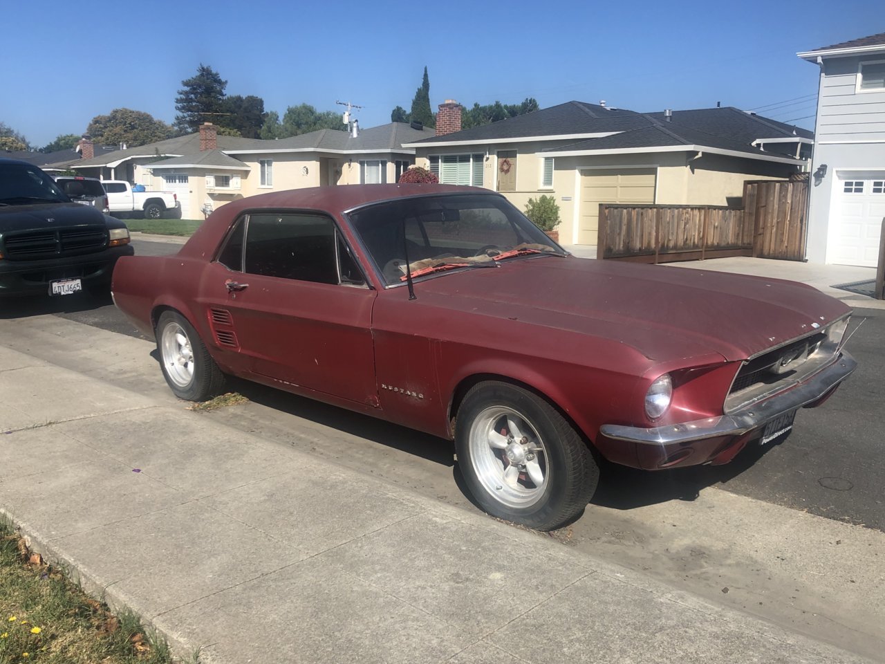

    Unrelated, but no pics of the mustang on your instagram

    The one linked is only for my truck. the mustang needs some love and restoration. Does have a rebuilt original 289 in it. Did run but I think the starter went out and been focused on the truck the past year.
  4. Aug 13, 2019 at 9:42 AM
    GT7
    GT7 One piece at a time
    Aug 15, 2014
    #136201
    2,502
    Grant
    Phoenix
    2013 DCLB
    lots of potential

    yah one day or may sell it to my brother and let him do his thing.
