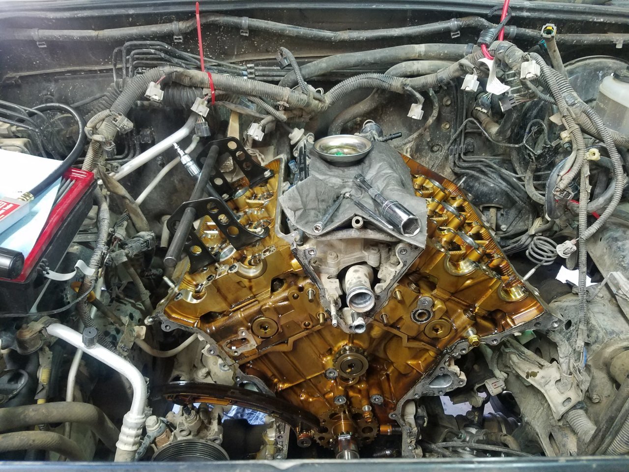

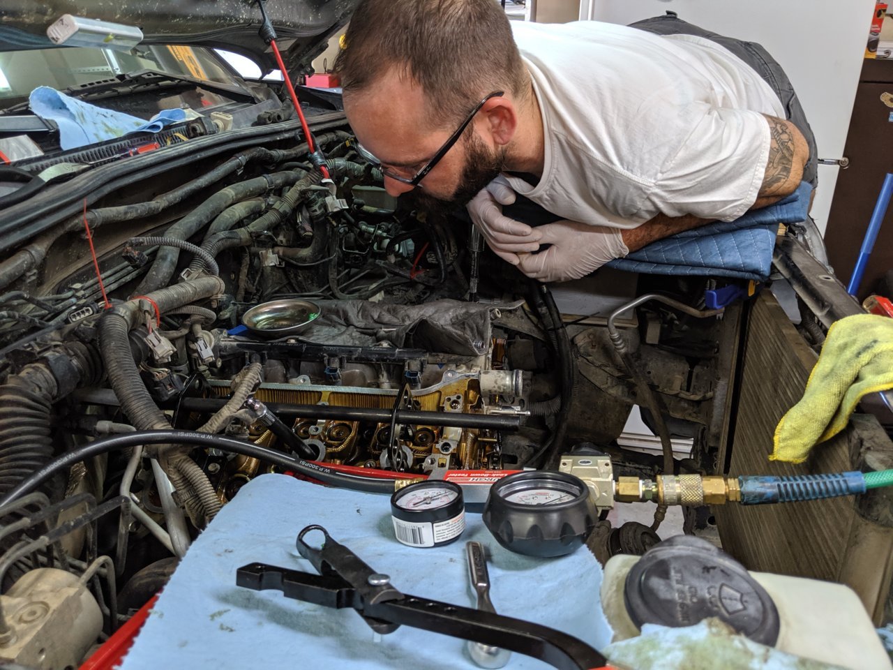

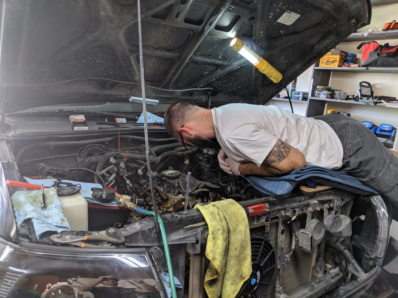

    Valve guide seals on cyl1 done. On the the next 5 cylinders.

    Well, it has been a long day. But, all the valve guide seals are done. Will start putting back together tomorrow. For now shower and date night with the lady.

    Seems like quite the job. What made you embark on this task and what resources did you use to get it all take apart/put together?

    I was consuming 1qt per 1k miles. I picked up a in car valve spring compressor kit. I will try and add a link later. An E8 to remove 2 studs at the bottom of the front timing cover. Oh yeah! I used a universal spark plug wire remover, but I cut off the plastic over the ends so the metal ends grabbed the seal to pull it off. I had a friend help operate the tool while I pulled out and installed the keepers.
    EWK Universal Overhead Cam Valve... https://www.amazon.com/dp/B00I2IYQ7A?ref=ppx_pop_mob_ap_share
