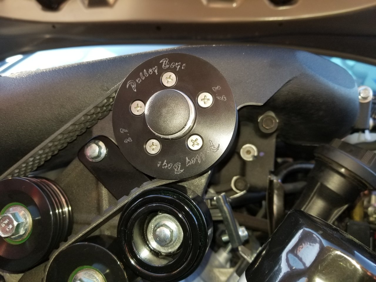

    Pulley wrap info:
    The timing belt kit is cheaper than a single pulley. Rock Auto is cheapest I found. Dayco 84041. I used the one with the bracket so I could adjust it since it has a slit in it. I trimmed the bracket down to essentially remove it. The bracket side will face toward the front of the truck.
    I used 4 washers on the back side of the pulley to space it away from the sc and 1/8 x 1" stainless bar stock[​IMG][​IMG][​IMG]for the new bracket. You have to have the bracket overhang on the drivers side about 1/2"so the spacer washers have a nice flat surface to mate against. Then you just need one washerfor the front of the pulley and longer bolts to replace the stock ones.20180225_173422.jpg
