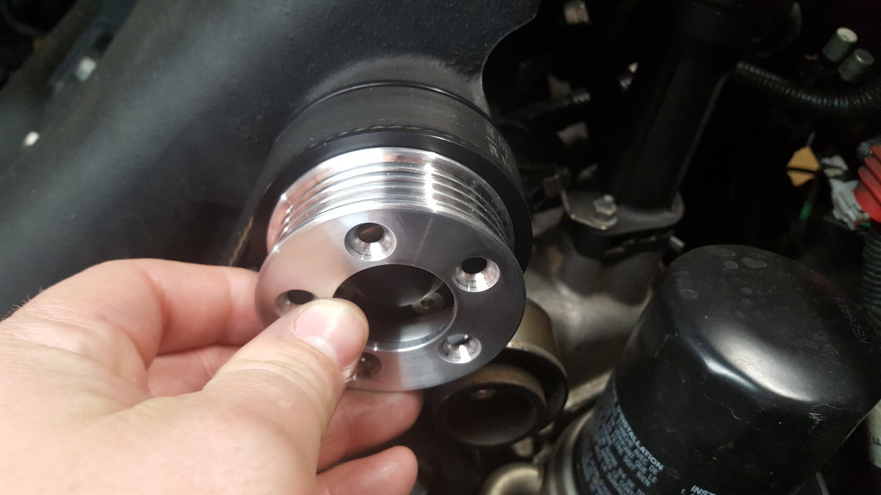

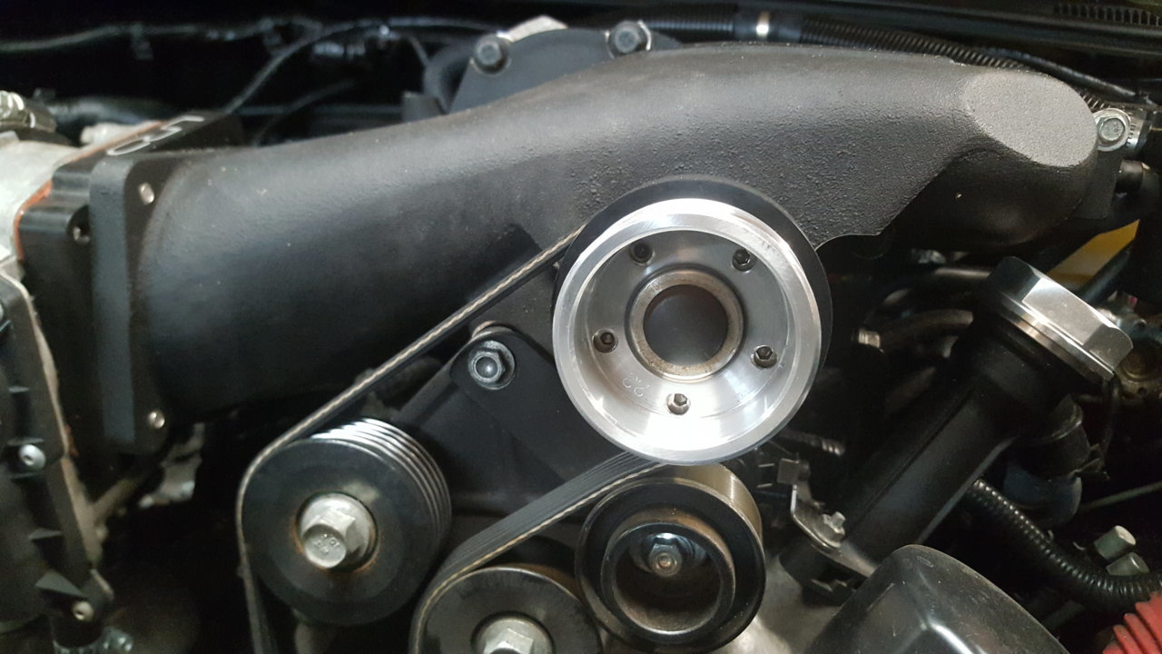

    This thing weighs almost nothing

    2.3?

    2.3.
