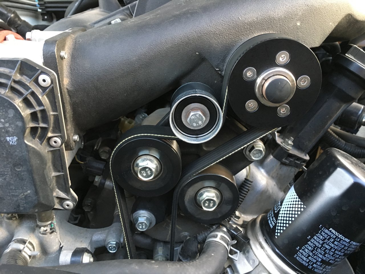

    Been looking at both @Roostfactor and @BillDaCat8 wrap mods and most likely @Roostfactor will be easier for me to get going.
    If I go that route which belt would be the best to use with a 2.5 pulley. Looks like @BillDaCat8 is needed for the RPM with OE Length but was unsure if @Roostfactor (although noted) is ok on the OE size belt or not as there is a extra note by @12TRDTacoma that he recommends the @BillDaCat8 version.

    Pics of @BillDaCat8 version?

    +1. The only issue with attempting to run his though is that it is not a straight plug and play install. It requires some lathe work or work with a drill press.

    @BillDaCat8 ok link to that pulley and bolt... please and thank you

    I share your interest, but don't think he provided any direct links - just a description "Audi/VW 1.8T timing belt idler. It's 40mm dia". Also, @12TRDTacoma is correct about it being a non-plug & play solution that requires some lathe work...
