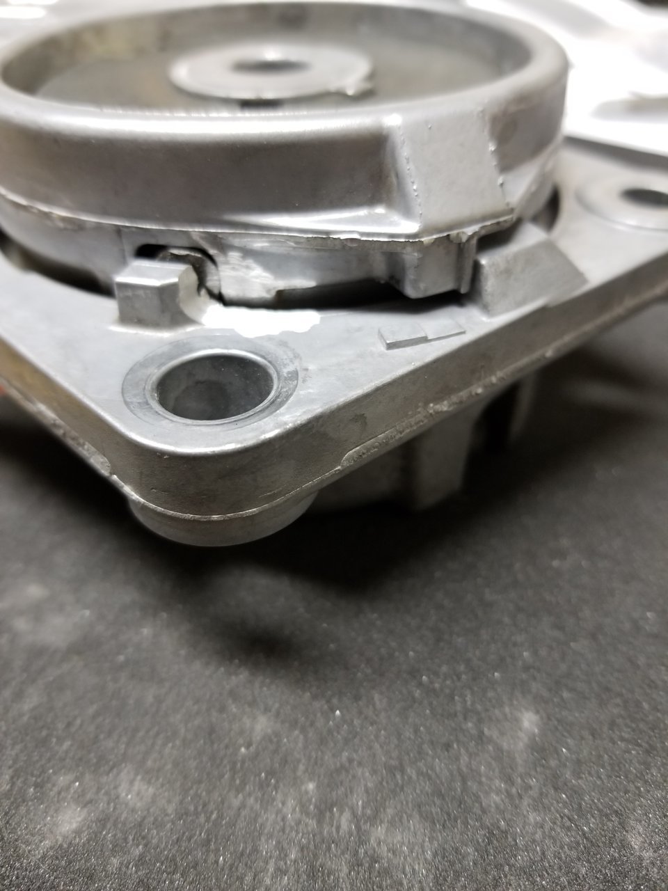

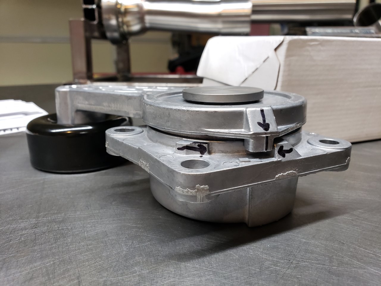

    This is for everyone regarding belt lengths. THE BIGGEST thing that needs to be visually verified by each installer ESPECIALLY when installing smaller pulleys, belt wraps, belt lengths, etc. is the adjustment range on the tensioner. Here is an example that I marked for easy reference.
    The indicator must be somewhat close to the middle to allow movement of the tensioner arm in both directions. The reason for this is that the tensioner is dynamic during engine operation. Even with the stiffest belts the tensioner arm is moving due to the loads on the belt during accel and decel.
    Here is a pic of how I modded my stock tensioner stop (before my Roush) to allow more range.
    I highly recommend checking your range on the tensioner whenever making any changes to the sc pulley/belt system!
