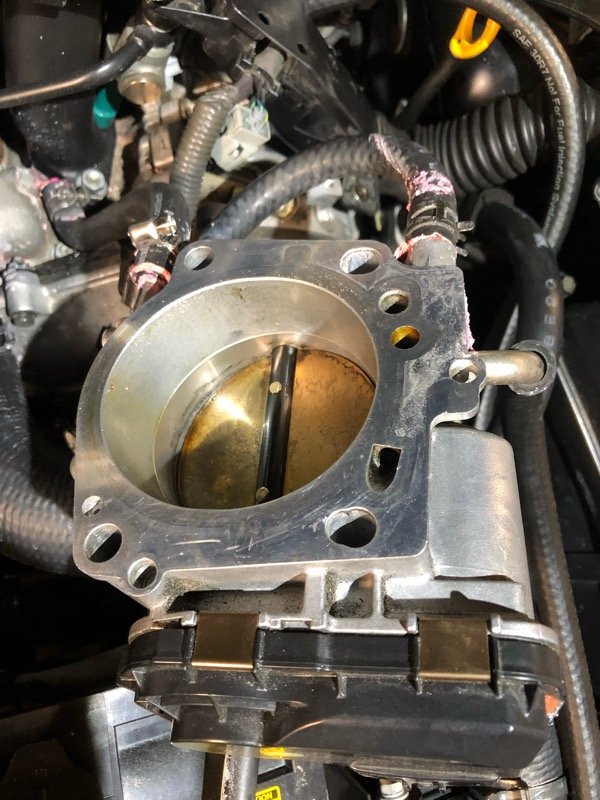

    So just for clarification, if I blow into the pcv hose that goes to the throttle body it should be closed right?
    Edit - I found the problem and the conclusion is I’m a dumbass :anonymous:

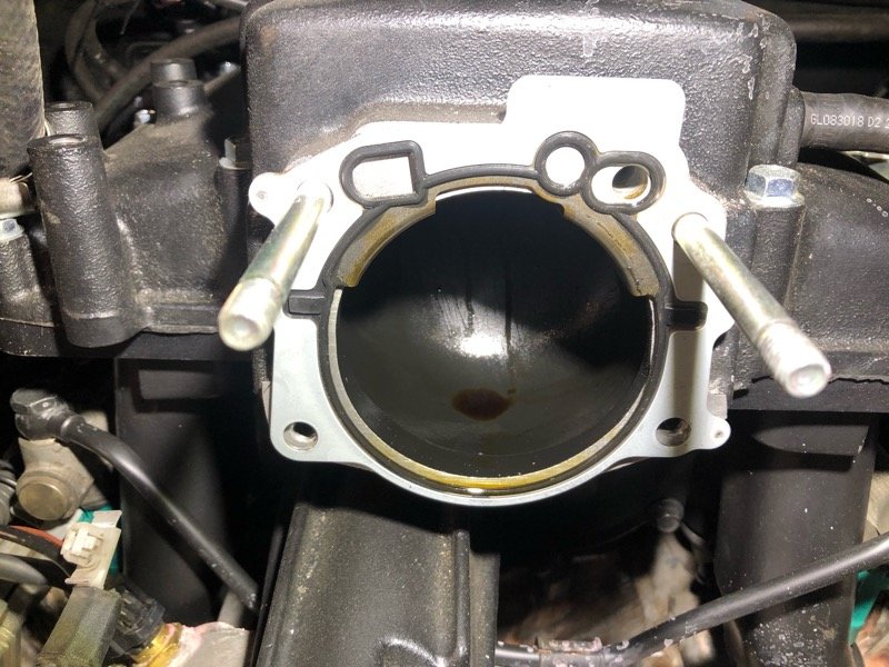

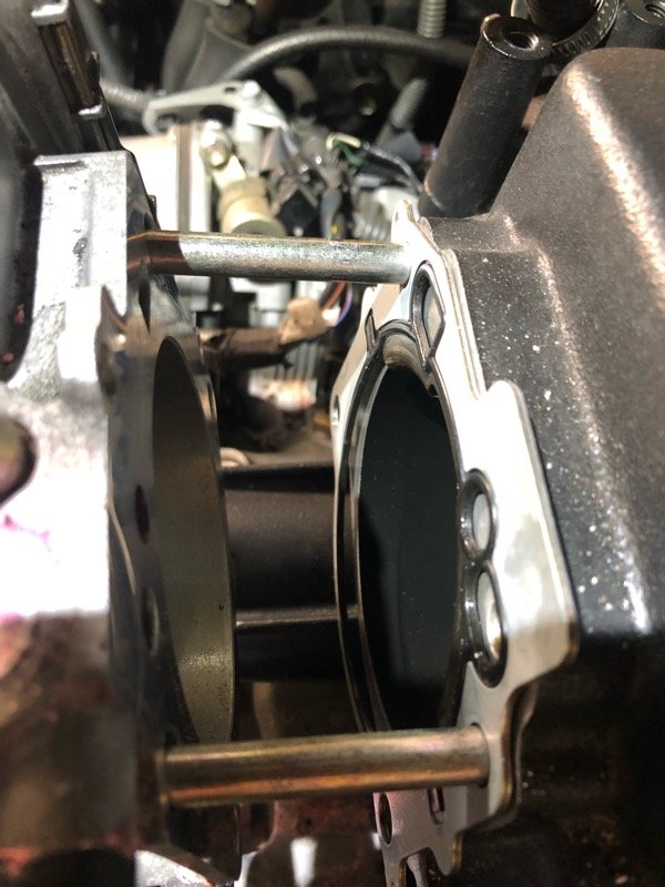

    So these are the little things you need to watch out for when adapting one thing from one car to another car.
    PCV port at the top right
    Blow by coming from the center hole instead of the right side on my Lexus TB
    And the end result of a dumbass that isn’t paying attention
    Ordered a TB meant for the Tundra and hopefully my catch can starts catching stuff.

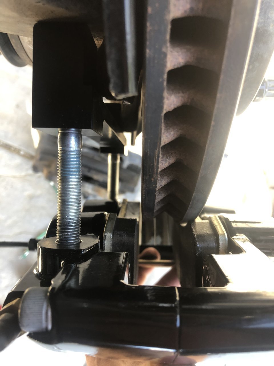

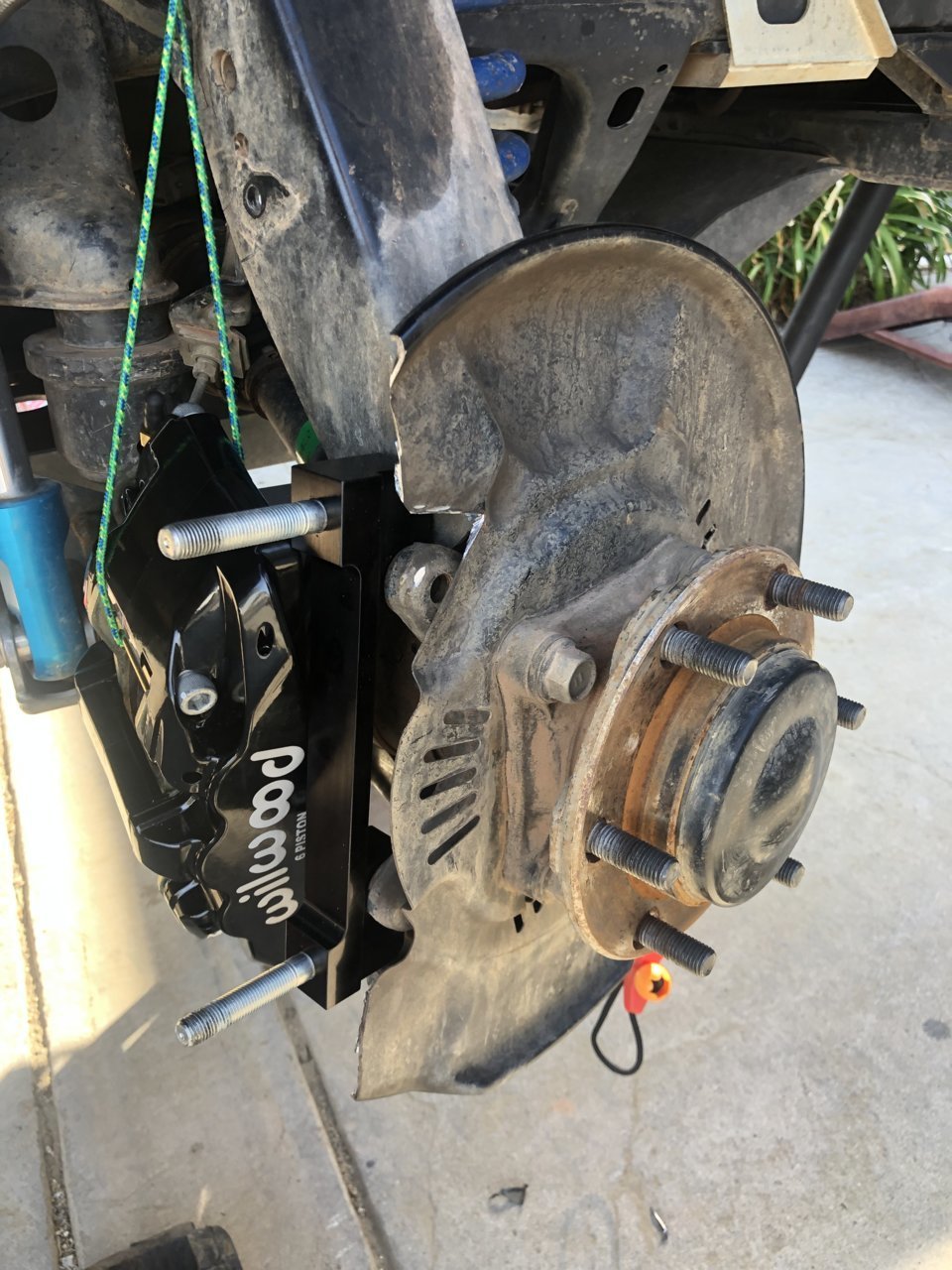

    My truck it out of commission too. Bought some new brakes supposed to fit a 4runner. I have 4runner brakes on it now. New setup won't line up. Maybe something if off but for the life of me I can not figure it out or they really just do not fit. Which boggles me since I have been running 4runner brakes for almost 2 years. Its off by 1/8" to 1/4"
    Maybe this collective has some bright ideas before I get too livid. =) Fixable by putting the stock ones one and bleeding the brakes but whats the fun in that.

    Thats what I am trying to install... the 4runner setup works just fine. Bigger rotors, slightly larger piston.
    Adding Wilwood 6 pot calipers to the setup. Uses the 4runner sized rotor which is 338mm.

    This has to be the most frustrating part. I can toss the 4runner calipers back on no problem and these are supposed to be setup for the 5th gen 4runner and GX460. They also fit FJ's since they fit 4runner stuff so it should fit on mine but NOOOOOOOOOOO. This was supposed to be an easy one. Even got speed bleeder to make my life easier. Go figure!
    Norton likes this.
