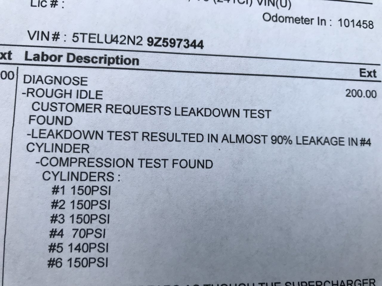

    No compression on cyl #4. Kinda like getting a cancer diagnosis I didn’t pay attention to the rest of the diagnostics. I asked the guy at the shop to leave me a detailed report. I’ll
    get it picked up after work.
    Only symptoms included: burning 1/4-1/2 quart oil every 3-5K miles, mildly rough idle, oil catch can filling up pretty quickly (small can filling up every 1000 miles). No smoking. No engine codes. No over heating (after CSF radiator max temp 195). All started on a road trip earlier this year. Then I had found my intercooler reservoir empty. No idea how long it was empty since I went 3-4 months without looking at it.
    Will probably go NA for a few months after new engine/ECU.

    I was just about to ask if the cooler fluid was circulating.
    Sounds like blown ring lands. A thick oil will mask the problem somewhat.

    Where was the leak showing itself? Crankcase?
    Who did the rebuild?

    Didn't you say you ran the inter cooler dry for while? Might be a main contributor to your ring land. I suspect it was my issue as well.

    Yeah. Earlier this year I posted about it (while on a road trip in May). And you had mentioned your troubles with the intercooler. It was at that time that the rough idle began. I agree that the dry intercooler may have been the culprit. After my road trip I got it all redone (new pump, hoses, reservoir) but too little too late.
    Got the SC installed ~25k ago at a local customs mechanic shop hyped by the x-overland people (you tube channel). Since then I found some folks on the Montana thread to be less than impressed with them. Not here to dis on the shop though, I’m at fault here.

    No grease on the skid plate. Some slow weeping / dry residue on the oil pan. Oil coming out of PVC valve (catch can filling quickly). Not too many symptoms to be honest.

    image.jpg This is the leakdown report I got.

    Yep, 4 is dead. Wow. That is surprising. Those intercooler pumps are critical apparently. Those running meth/ water injection are doing their engines a good favor.

    Yes, especially in summer months. I feel like I’ve been sounding like Bob Barker reminding everyone to “spay and neuter their pets” with my constant reminders to check yo pumps!
