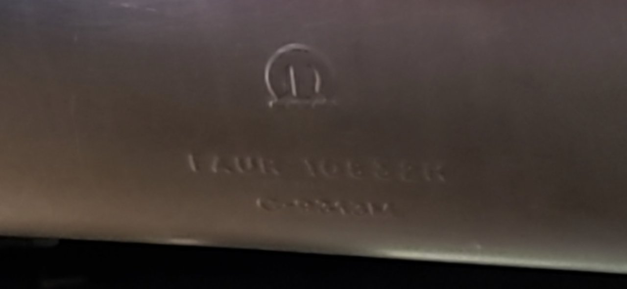

    What is the part number on the side of it? Been looking around for one locally and want to make sure I get the correct one.

    I’d go look at mine but the truck is at home. Found this old pic on my phone and zoomed it in. Looks like:
    FAUR 10832H
    C9313M

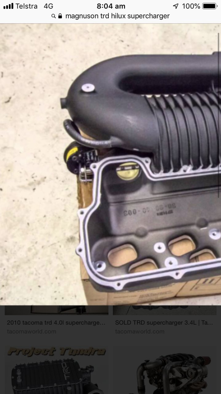

    It’s just a short line and it connects to a port at the back of the charger.

    Yeah I would agree. I can only be something with the vacuum. Weather is mechanical or ecu related, it has to be the vacuum
    this is not my actual sc but it’s the same one. This is exactly how my vacuum line is connected
