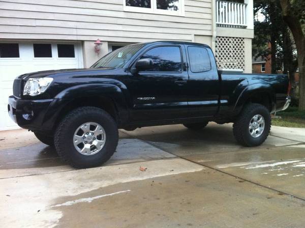

    I bought used. No hood scoop... (yet). So yeah heres a pic.

    Looks like an SR5, non TRD

    Ok! Thanks!

    Looks like an SR5. I'm assuming no rear differential locker?

    Or, the previous owner debadged and traded it in with steelies... No way you can say it's DEFINITELY one thing or another until you see the switches to the left of the steering wheel.

    I'm saying the previous owner could have sold off the TRD Off Road alloy wheels and slapped on a cheap set of steelies to trade the truck in. I can think of a lot of people who would do something like that.
