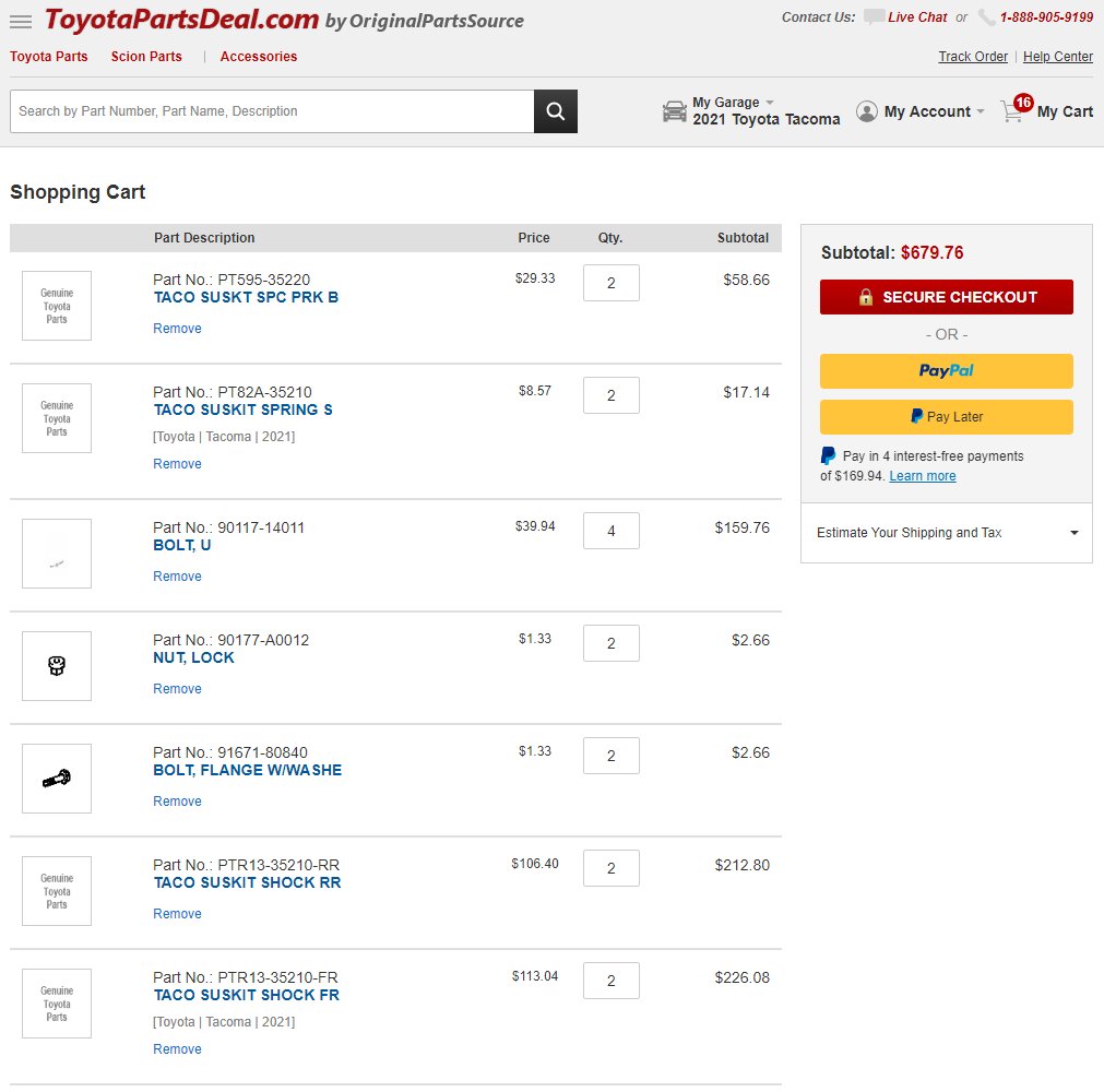

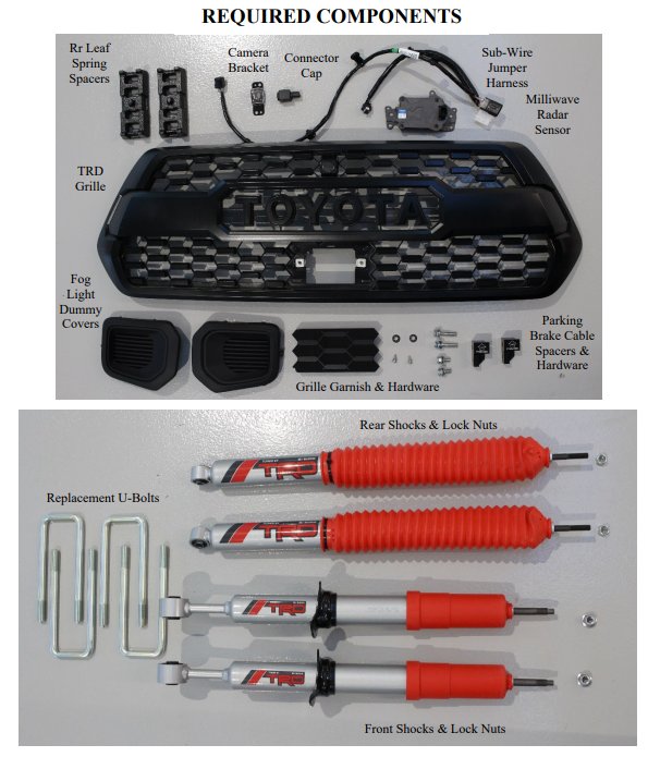

    Instead of getting the entire $1,500 "kit"(PT84K-35221), as I already have a "Pro" grille, I plan on piecing together just the suspension parts from ToyotaPartsDeal.com for $680. And instead of having the dealership install it for ~$900, I'm going to have a local tire & suspension shop install it.
    FULL KIT:
    MY ALTERNATIVE:
    After some further forum digging I'm think I am skipping the Toyota 1" Block Spacers and U-Bolts and instead get the "ICON add-a-leaf" kit, as it would only be an additional $50 upgrade. Based on my reading, people say it's worth doing over just throwing on the spacers.

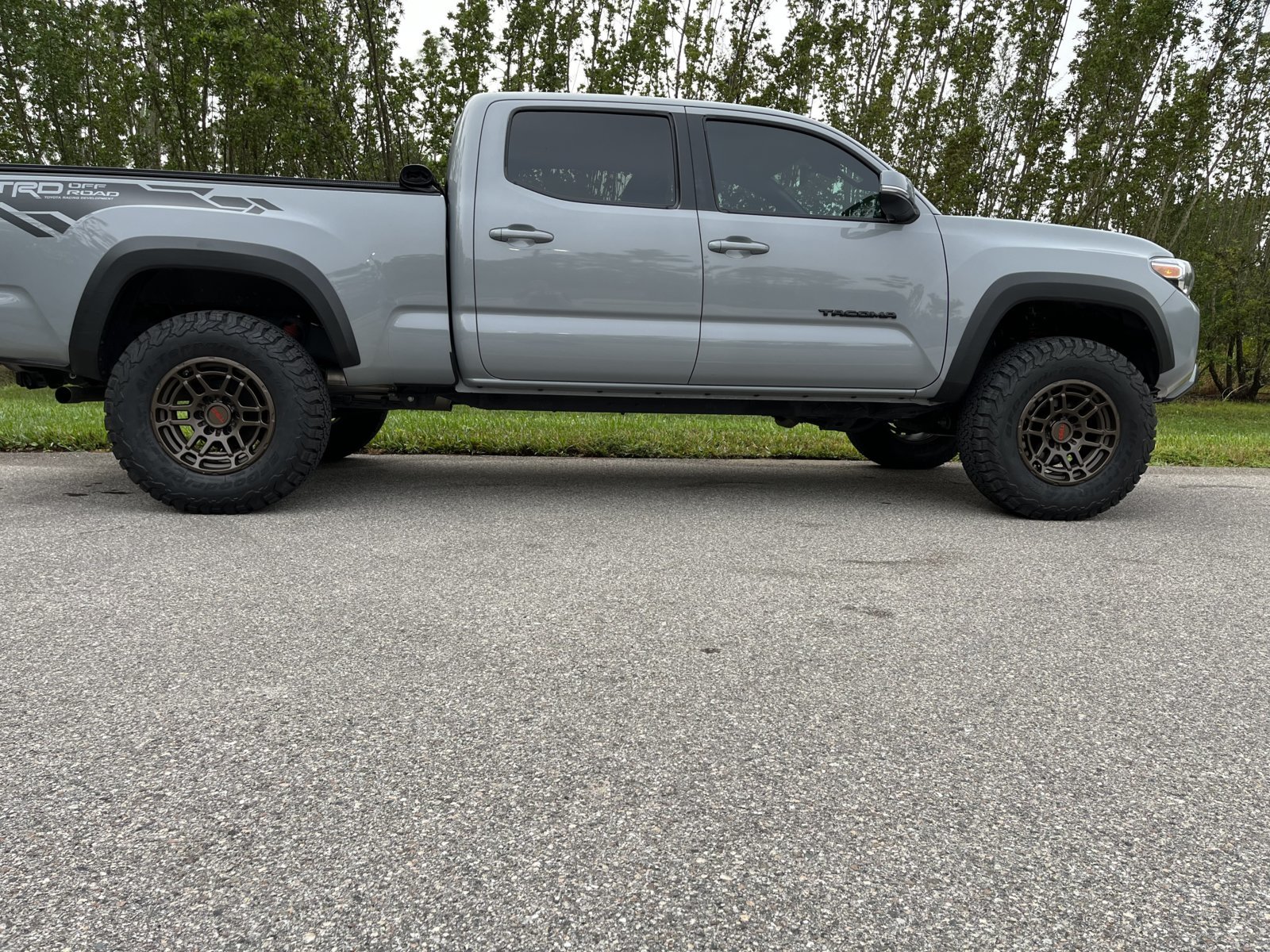

    This is exactly what I did on my 2020 Off Road and it turned out great. No calibration done. Definitely have an alignment done once completed.

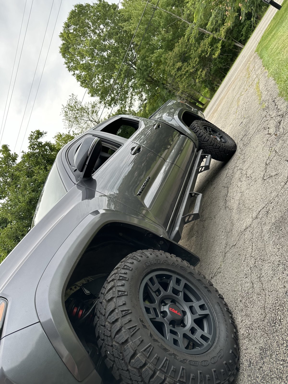

    Worked perfectly!

    Nothing wrong with the rear 1" block, unless you plan to tow a lot.

    Is it me, or does this look like the front end is lower? Like the oem slant?

    Agreed, blocks are just fine especially just a 1 inch one and the trd/billstein 5100 rear shock is longer anyway

    Good to know, I have a feeling I'm going to add a rack and RTT at some point so I figured the "add-a-leaf" would also be future proof

    It’s supposed to be lower. Has a 2” front lift and 1.25” rear, which still maintains some rake…. Like trucks are supposed to have.
