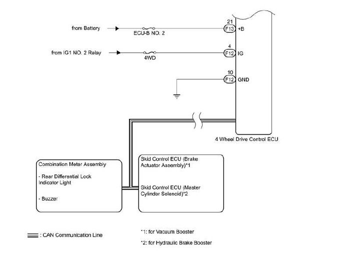

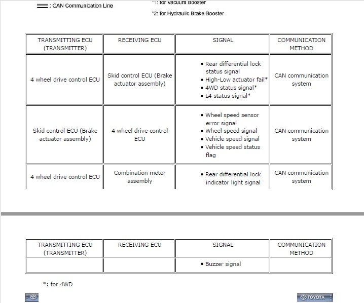

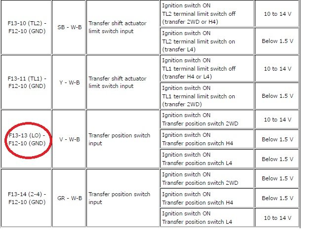

    I've looked at the schematics and I don't think there is going to be any easy way to engage the locker without tripping out the ABS unit and Transfer case controller. The locker runs through both

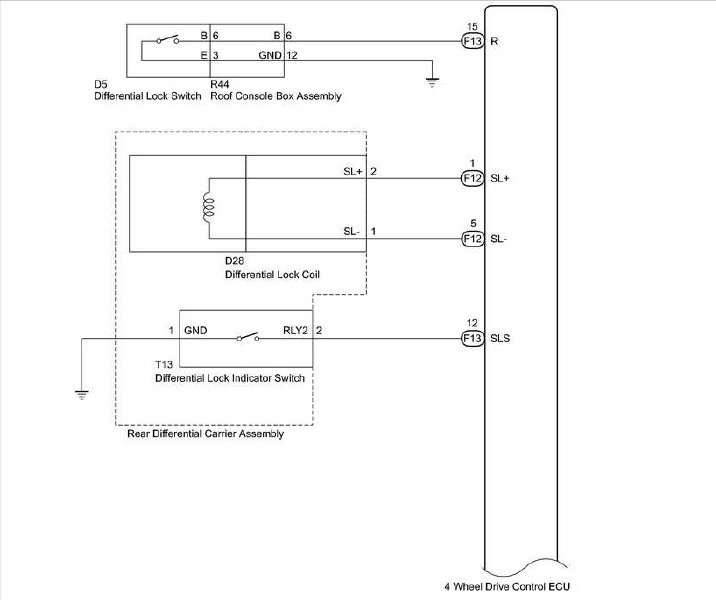

    I think it really depends what's required by the 4WD ECU.
    I believe that mod only fools it into thinking it's in 4lo.
    As you can see, there's a lot going on in the CAN lines.
    Mobtown Offroad likes this.

    You could provide power and ground to the coil and hope that backfeeding the module doesn't cause issues

    I suppose you could add diodes between the actuator and the module to keep from back feeding. Hmm, now I'm getting ideas. Lol

    I don't think so.
    Besides, I believe it's a violet wire? Terminal 13(Connector F13) from the 4WD ECU.

    Someone is just going to have to try some of the suggestions and see if it works. We might bet lucky, but the more CAN gets integrated, the harder it is to make a simple "X-wire hack". But, we could get lucky.
    The next option is a custom module that snags the CAN communication and modifies it to suit the modder's nefarious needs. Sounds crazy, but there are products that do exactly that for many cars. I had a small part in (assisting/promoting) development of a unit to modify the way the retractable hardtop works on the 3rd gen Miata. The company that builds it also makes modules (same module, different firmware and wiring harness) for many other vehicles. Mods4Cars.com

    Disregard previous post; my bad.
    Yellow wire, Terminal 3, Connector F13 from 4WD ECU.
