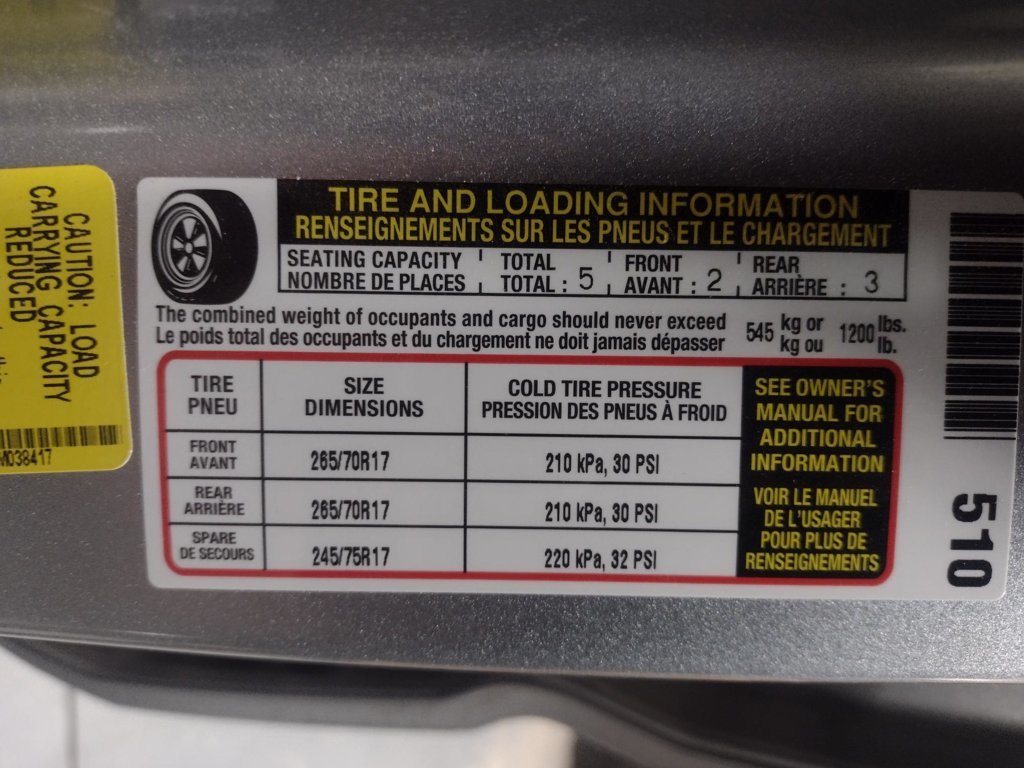

    According to Toyota’s specifications the TRDOR with 6’ bed has highest payload between the other TRDOR variants. Does someone have one of these and can post what their payload is? Is it actually 1655 lbs give or take, or is that a make believe number?

    Mine says 1200. Where are you finding 1655?

    Thanks soupy. That is the max payload listed on Toyota.com for the TRDOR with 4x4 and 6 ft bed.

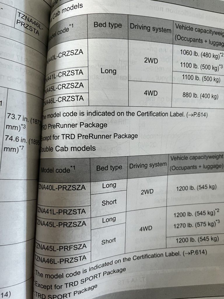

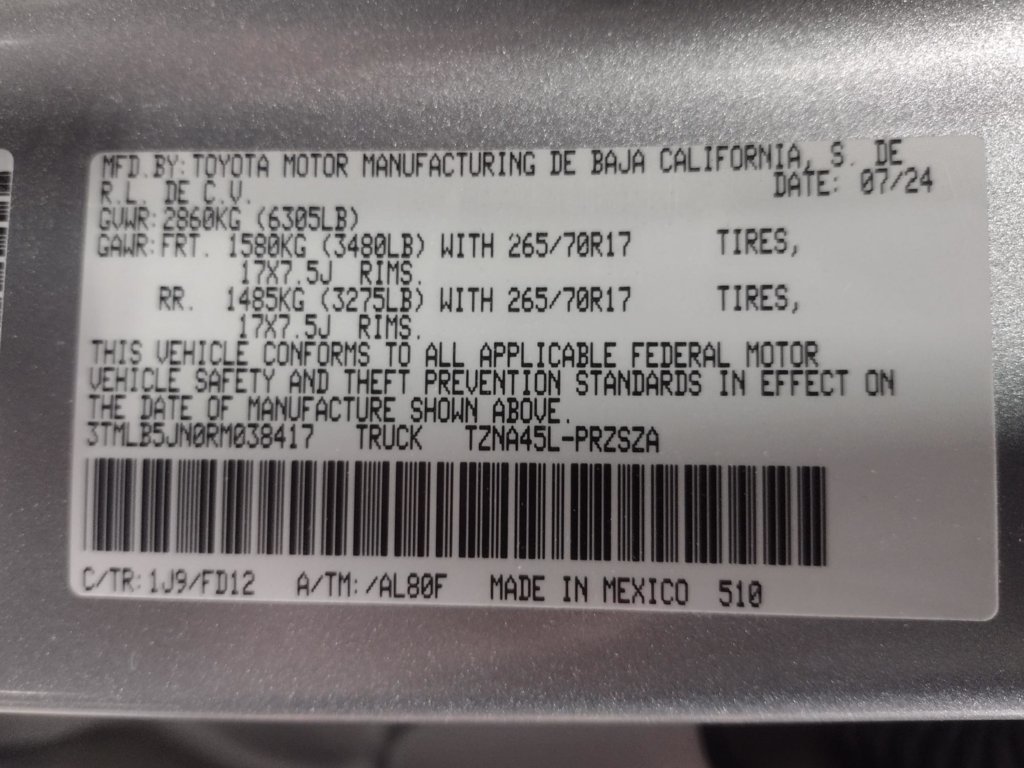

    Here’s what is listed in the manual… dependent on keeping stock wheel and tires
