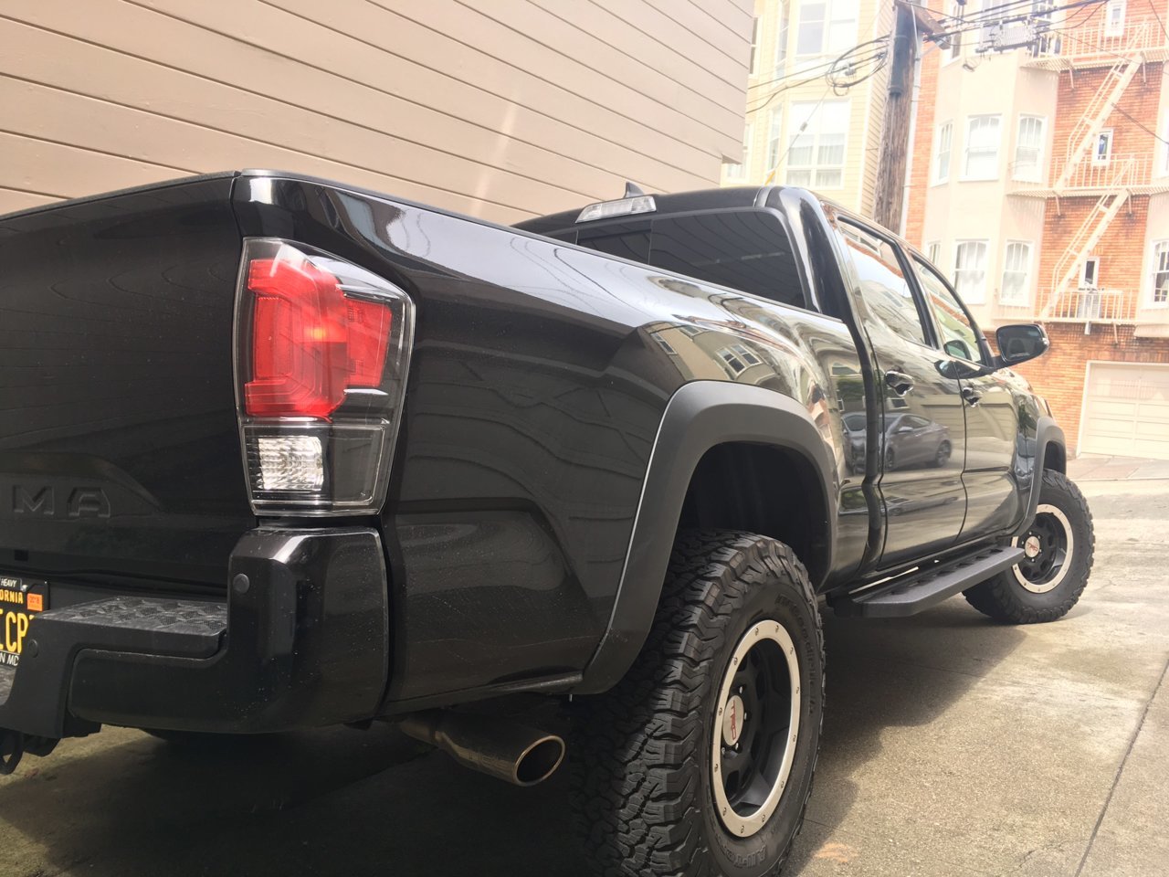

    The ring does not stick out beyond the outer wall of the tire so it does not hit the curb, I'm running 265/75/16 KO2s. You do need to purchase the longer lug nuts and I was able to reuse my TPMS from my OEM OffRoad so no need to buy new ones. If memory serves me right these wheels have an 11 MM offset so they'll widen the track by roughly 0.86 inches.

    Captain Tikihut that's the same tire size I'd like to put on. Do you have a lift or stock and have you had any rubbing problems?

    Not the quoted member but I’ve had those wheels with that size on two trucks.
    You’ll hit the flaps on turns if you are at just the right angle like turning into and reversing out of driveways.

    I also have 265/75/16s. No flaps, no rubbing. I went Bridgestone Dueler AT Revo 3.

    No rubbing, no lift but I did swap out the stock OEM Bilstein shocks for the Fox from the Pro.
