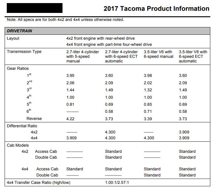

    Here is the gear ratio from the factory. I wish i knew what any of this meant.. :confused:

    Is yours the 6 speed 4 cyl? My truck stock gears are the last one. 3.5-liter V6 with 6-speed ECT Auto

    Yea 6speed automagic gear box for me. Correct me if im wrong, so the gears are the same?

    Seems like it. Other than the Differential Ratio. Maybe someone with more knowledge can chime in here.

    Sorry @dbuck294 should have been more specific. Looks like your 2.7L Automatic Runs 4:30 gears. To return your truck to more stock like acceleration you should put 4.88's in.
    The gearing is the same in all 6spd automatics transmissions.
    Check out the 4.88 mega thread.
    Also your truck is the last of its kind. They stopped selling the 4cyl in Canada for 2018. So hang on to it, it will be sought after.

    I just want to touch base with this one more time. Im running 285/70/17 and now i have decided to take the plunge do the regear. But does it make more sense to do the 5.29 or the 4.88?

    4.88 bud. You only want those 5.29s if your doing some serious crawling on 35's. 4.88 will give you better torque up hills with those 285's. 4.56 would be close to stock with your 285's, but they don't make em. And that extra 0.32 you get with the 4.88's will do you good.
