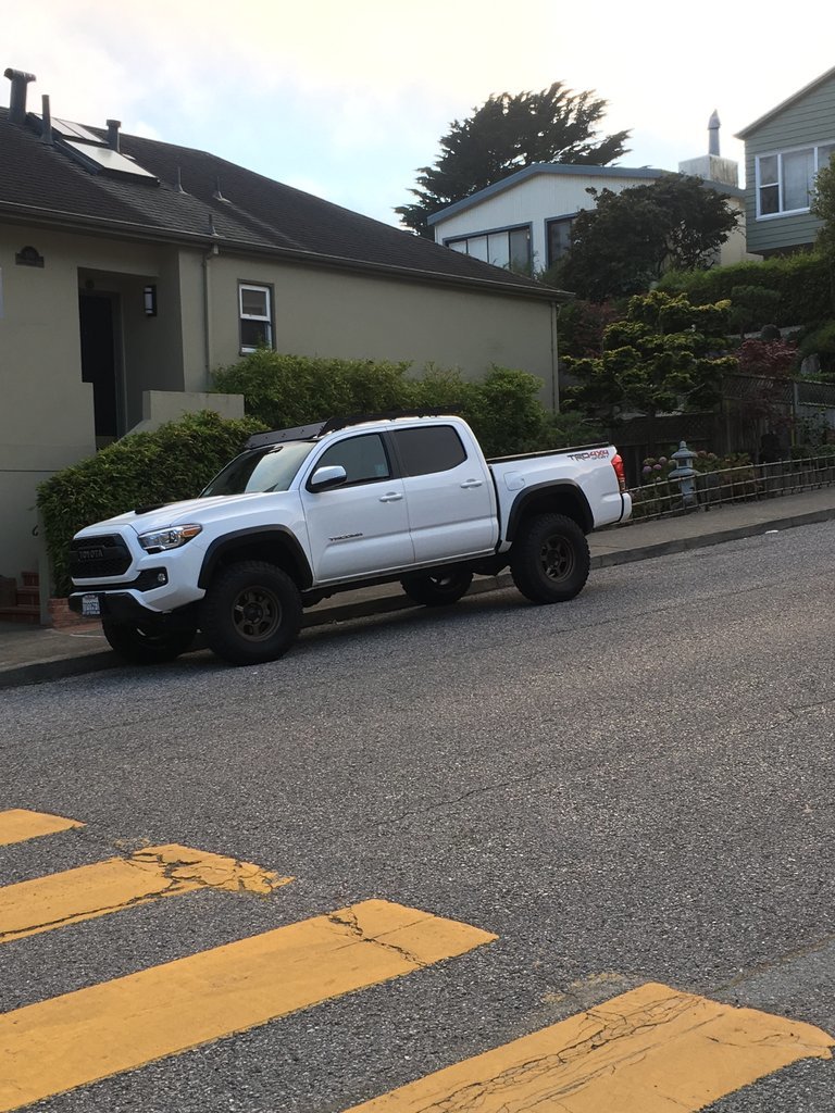

  12. Aug 29, 2017 at 11:17 PM
    ajwhos
    ajwhos Well-Known Member
    Aug 7, 2017
    #226245
    77
    aj
    3rd gen taco
    the wrap looks great!

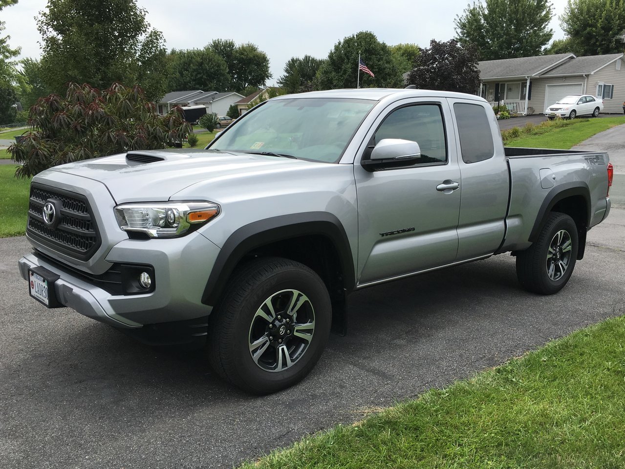

    Thats what I did. Turned out nice. Cheap and reversible. I haven't read the entire thread yet so it's prob already been mentioned, there is a flare trading thread in the buy/sell/trade section.

    Do most body shops do wraps like this? Not sure I would find a place around who would do this but love the look.
    How much does this cost usually? Fenders, and front lip.

    Im not sure of body shops even do wraps. You gotta ask the body shop. I went to a specific shop that vinyl wraps cars. I paid 250 for the 4 flares, hood scoop, and lower bumper piece.
